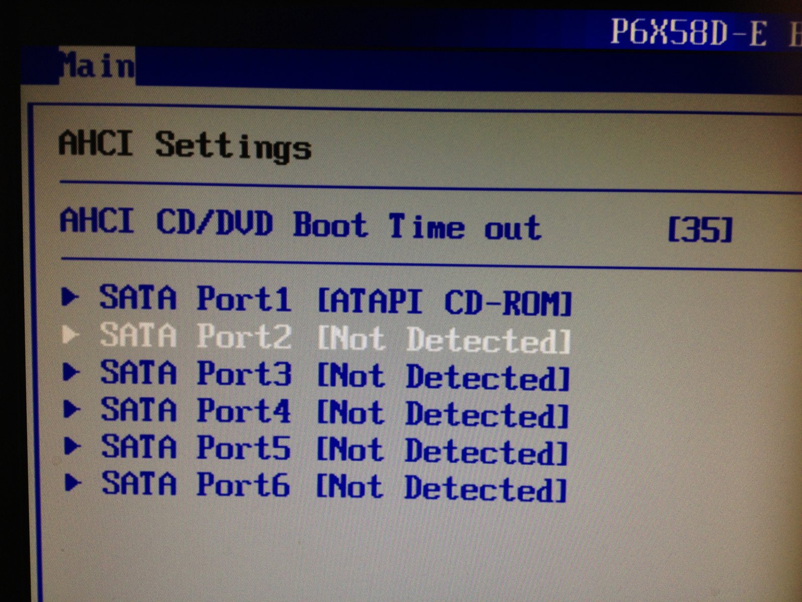

AhcI mode is not showing my hard drive as posted

Please answer pirateghost's request for "You also have not mentioned your hardware. What motherboard, sata controller, ram, etc".
Based on your jpeg, you have a Asus P6X58D-E motherboard. If your hard disk is plugged into a gray SATA connector (Marvel controller), please move it to one of the blue ones (Intel).

thanks all for the reply and giving the helping hand! finally I made it work!
for the future reference I am going to post about all the noob steps to install freenas:
1. you need a usb key (least2-4gb size);
2. you will have to burn the freenas img to a cd or dvd;
3. you will need to set motherboard BIOs before install (boot order, sata type:ahci mode & look into advance tab for hard drive mode to ahci as well)
that's what I did to made my drive show up on the GUI.
thanks all again! can't wait to use it!
