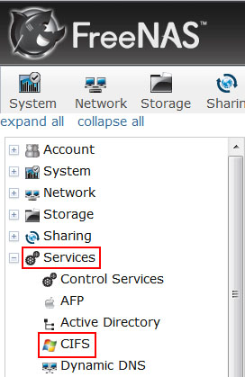

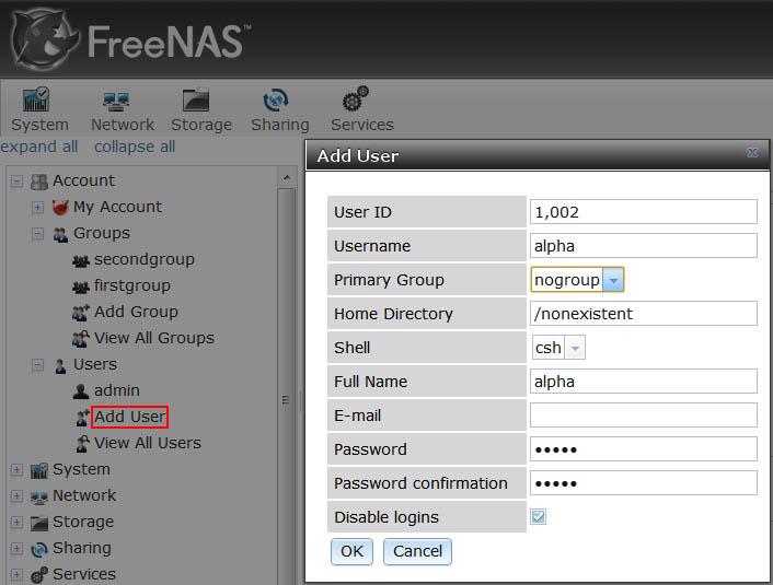

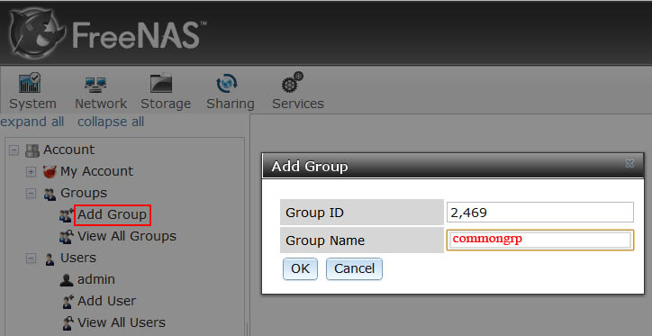

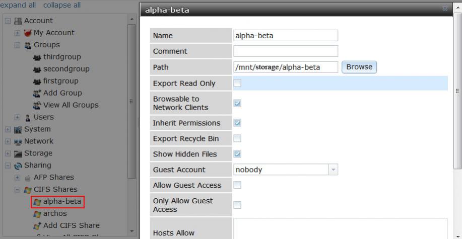

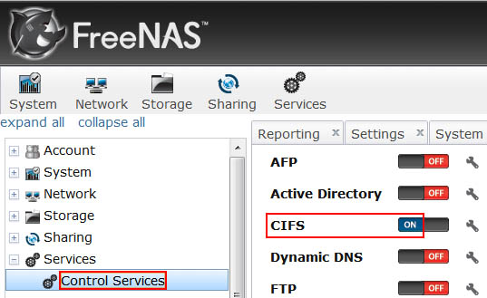

If you have 2 or more users that want to have private personal folders, but want to share a common folder that a certain 'group' of users have full common access to, this is a guide to start from. Note: This guide is based on FreeNAS 8.01 beta4 The folders here are for example only, the '/mnt/storage' should be replaced with the name of your volume which you can find by doing a 'df' from the command line on the FreeNAS system (using ssh to login). Look for the line that shows '/mnt/your-volume-name'.
DUE TO FORUM CONSTRAINTS YOU CAN NOW FIND THIS HOW-TO AT THE LINK BELOW:
General Permissions & Sharing folders between users
I'll still respond to questions here or there, but please read this entire thread before asking questions.
