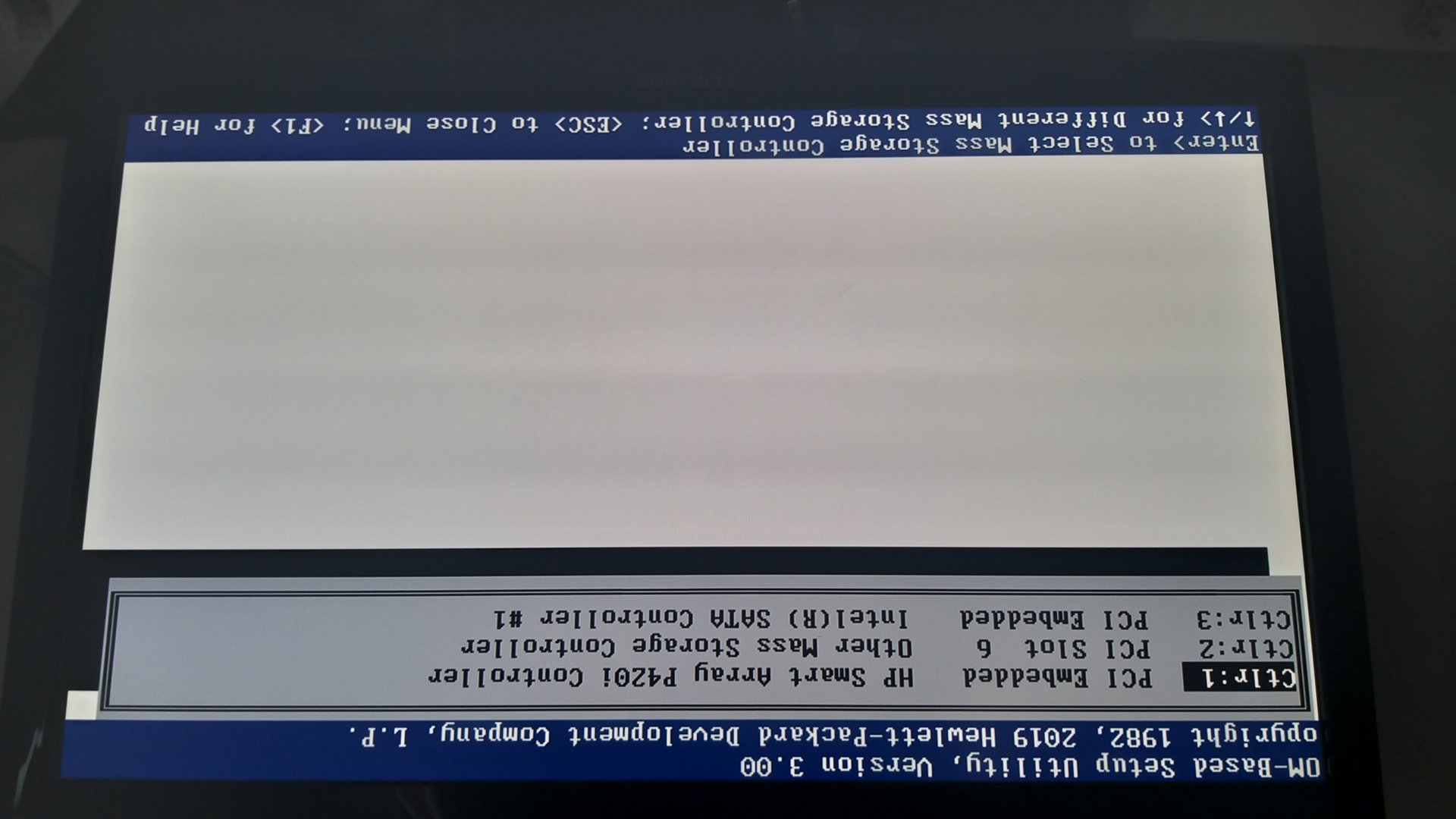

Hey guys,
so I'm having this weird issue where my server hardware doesn't recognize my PCIe to m.2 ssd, it flags it as "Other storage device", but when I use the TrueNAS installer it does see it. This is also the other way around where TrueNAS won't pick up physical drives and I have to make them logical drives by using a raid. I don't mind making logical drives but the SSD is a problem. Is this some common issue?

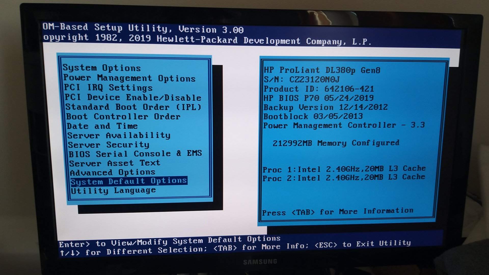

Yea that would be amazing, issue where do I do that? I only see how to access my ROM-BSU and iLO

Standard Boot Order or Boot Controller Order might have an option to pick BIOS/Legacy or UEFI.

Google your server model and "UEFI boot support" ... maybe?
BIOS update?
Have you just tried installing TrueNAS with UEFI already? You just pick the boot method when you run the installer.
Patrick M. Hausen
Nov 25, 2013
7,776
NO - rEFInd is an EFI boot loader. If you cannot boot UEFI neither rEFInd nor Clover will have any use for you.
You need a different boot medium connected to SATA or USB.
