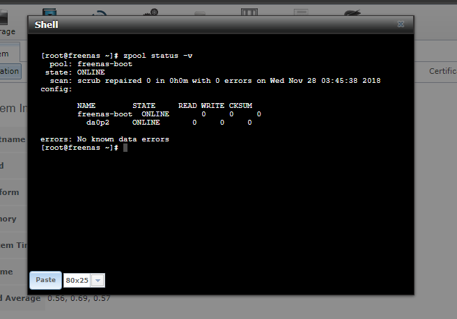

12
I used the FreeNAS Shell
[root@freenas ~]# zpool status -v
pool: freenas-boot
state: ONLINE
scan: scrub repaired 0 in 0h0m with 0 errors on Wed Nov 28 03:45:38 2018
config:
NAME STATE READ WRITE CKSUM
freenas-boot ONLINE 0 0 0
da0p2 ONLINE 0 0 0
errors: No known data errors
[root@freenas ~]#
Chris Moore
May 2, 2015
10,079
The shell in the GUI is incredibly limited because you can't scroll back to see what went off the screen. If you had a pool, which you don't, you would not have been able to capture the data through the shell window.
It would be a good idea for you to setup the SSH service so you can use something like Cygwin or PuTTY to SSH in to a terminal window.
https://www.ixsystems.com/documentation/freenas/9.3/freenas_services.html#ssh
What this is showing is very bad. Either the disk controller that runs the drives has failed and all the drives are not showing up, or you used a hardware RAID controller to configure the drive and the hardware RAID has failed because of too many failed drives.
Not looking good.

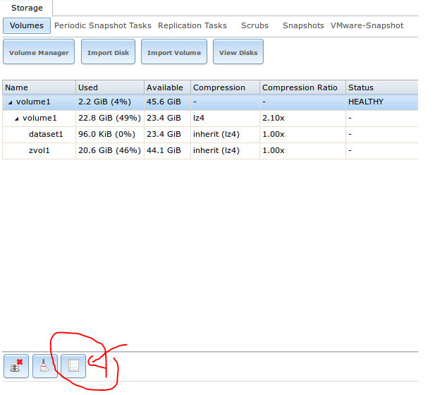

Lets look at the GUI.

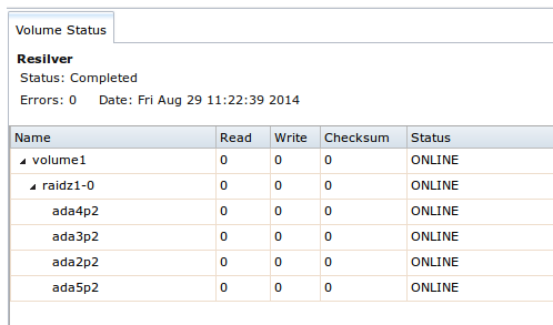

If you go to "View Volumes" in the GUI, here is the manual page if you need it:
https://www.ixsystems.com/documentation/freenas/9.3/freenas_storage.html#view-volumes
and click on the button at the bottom:
This should show you a list of the disks that make the volume. Please share that with us.
It should look something like this, but I am guessing that it does not:

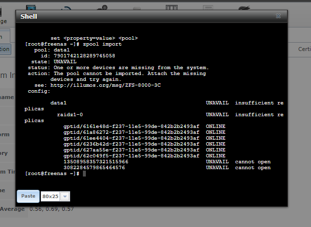

Feb 12, 2016
12
I ran a zpool status -v within the shell of FreeNAS and the image is what the message returned. Then I ran a zpool import, all my disks are online, but when I looked up the error message, it indicated that a device is missing. In the case of FreeNAS, what is a "device" I can think of 1,000 different things that a device can be

Mlovelace
Aug 19, 2014
1,111
Well, based on your zpool-import picture your data1 pool is raidz1 with two unavailable drives. So, if both drives are in fact dead your data1 pool is gone. Hopefully you have backups of that data.
Feb 12, 2016
12
So, thats interesting (Mlovelace), all my hard drives are running with green lights on the physical storage unit. there are only 6, I count 6 "ONLINE" on the shell - how can you declare 2 are dead, by this:
13508958357321515966 UNAVAIL cannot open
3082284579865464576 UNAVAIL cannot open
Mlovelace
Aug 19, 2014
1,111
The lights are on, but no one is home. The drives are unavailable to the pool, and I didn't say the drives were dead, I said if both drives are in fact dead. You need to see why the drives are unavailable.
