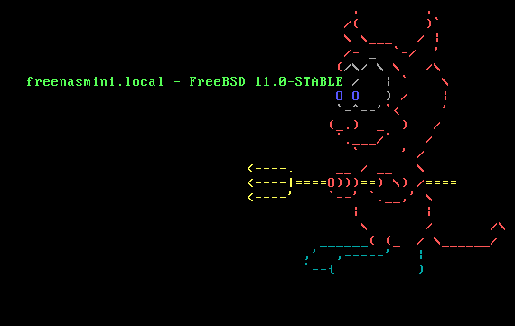

How do you change from the Default Screensaver in FreeNAS11?
UPDATE
So if anyone else needs this info The Screen saver is located @ /conf/base/etc/
File is rc.conf.local
Search for Saver
The Saver will be daemon just change to one of the available Screen Savers. You Just need the first part of the filename.
Example = "rain"
List of Screen savers in FreeNAS 11
blank_saver.ko This screen saver simply blanks the screen.
beastie_saver.ko Animated graphical BSD Daemon.
daemon_saver.ko Animated BSD Daemon screen saver.
dragon_saver.ko Draws a random dragon curve.
fade_saver.ko The screen will gradually fade away.
fire_saver.ko A fire which becomes higher as load increases.
green_saver.ko The screen will be blanked, similar to blank_saver.ko.
If the monitor and the video card's BIOS support it the
screen will also be powered off.
logo_saver.ko Animated graphical FreeBSD logo.
plasma_saver.ko Draws an animated interference pattern.
rain_saver.ko Draws a shower on the screen.
snake_saver.ko Draws a snake of string.
star_saver.ko Twinkling stars.
warp_saver.ko Streaking stars.

You're telling me your machine is displaying an animated screensaver featuring Beastie?
15,504
people are telling me that it does not exist
That's because what you're describing doesn't exist in FreeNAS, at least as far as any of us has seen. FreeNAS is a text-only environment. It has no graphics capabilities whatsoever. It boots to a text menu (containing 14 options, if memory serves correctly). After a period of inactivity, it blanks the screen and puts the monitor in standby mode. That's it. If you're seeing behavior different from this, I (and I expect everyone else here) would be very interested in seeing some screenshots.
Edit: Might daemon_saver.ko have been activated somehow? It certainly isn't the default, but looks like it's available...
I'm actually investigating this a little. The old sc console did support screensavers, which are kernel modules for some reason that scares me. The latest information I can find about the new vt console is that it does not support screensavers (yet).
I'm running a test on one of my boxes. FreeNAS defaults to vt on my X10SLM+-F, so I enabled the screensaver and rebooted to see what would happen. I'll update in 10 minutes, after the timer is supposed to expire.
I'm also looking at the serial console, to see what, if anything, happens there.

What about this one (from the console menu)?
https://www.freebsd.org/cgi/man.cgi?query=screensaver&apropos=0
No screensavers here when using the vt console.
OP, if, for some inexplicable reason, you really want a screensaver and really want a different one, read up on the FreeBSD documentation, as linked by @Redcoat above.
How do you determine/control which console is used?
This bug ticket should have most of the information.
IIRC, FreeNAS defaults to vt when using UEFI, as sc does not/did not work with UEFI video modes.
