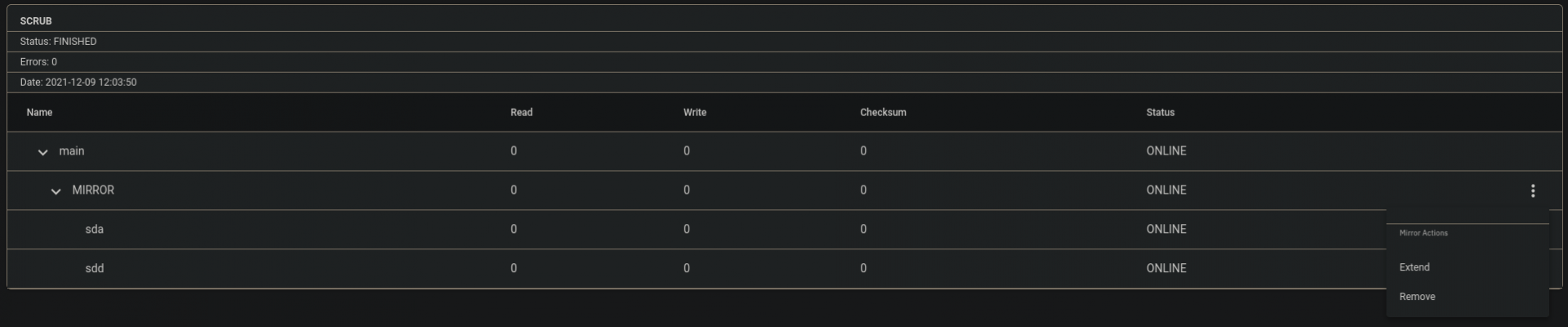

How do I do that? Does this mean Extend on the Web is wrong?

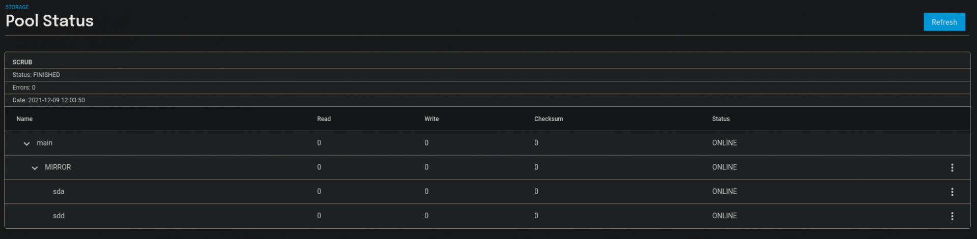

The term extend is confusing in my opinion (since it's actually attach in the cli and you're attaching a disk to the mirror), but it's the correct option to select to get the job done.
Select the 3 dots on the mirror line and you'll be fine.
9,700

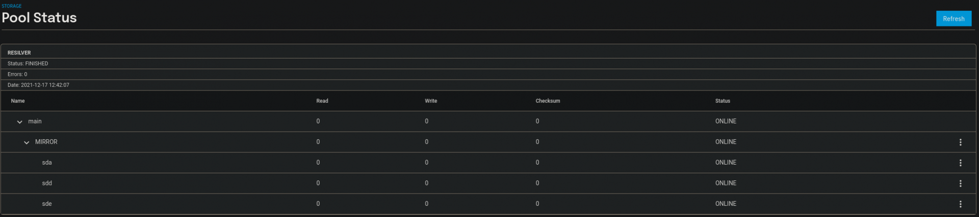

Checking how it looks in the Status of the pool would also be good, just to make sure the 3rd disk is actually part of the mirror and not a separate VDEV. (I'm almost certain that will be the case, but both cases will result in the disk being shown as a pool member).
