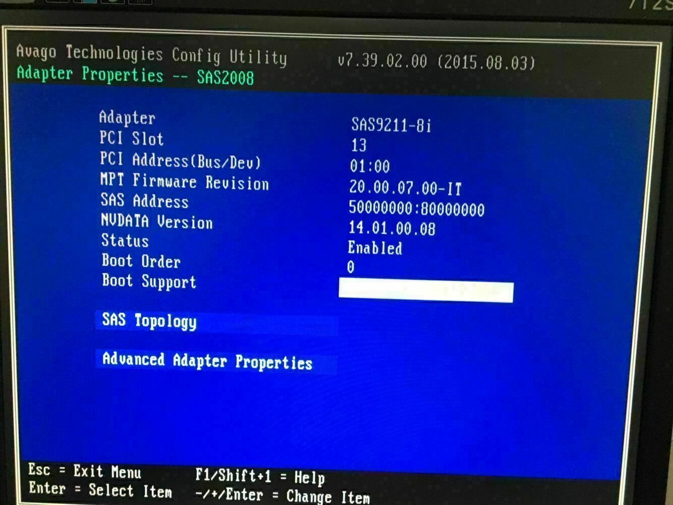

Thanks for the advice, as I do not live in the US to bring Boards from another country is in just 1 attempt, so as not to have to do it 2 times, that's why I chose the 8i model, and searching I found a similar card "Fujitsu 9211-8i 6G HBA LSI FW: P20 IT Mode ZFS FreeNAS unRAID" which is on ebay, the description says that it is ready for Freenas (TrueNAS now) and puts some images of the card information, I think from BIOS or POST.
Can you tell me if it is suitable for TrueNAS?
My intention to use it for RAID 1, the equipment I have is an HP ELITEDESK 800 G1 Small Form Factor With an Intel Core i5 4590 with 12 Gb TrueNAS-12.0-U5.
I will have to purchase an HDD box in the future to add more HDD.
I accompany the image that the ebay seller used.
I have a question with the description "unRAID"
what does it mean?
Thank you
It's helpful if you use the ZFS terminology, when referencing ZFS RAID configurations. For example, ZFS does not support RAID-1, but supports Mirrored vDevs, which is quite similar. So it's possible you meant to use a hardware RAID card with it's hardware RAID-1, instead of ZFS Mirrored vDev.
Here is a link to the resource on the subject;
what does it mean?
There is a piece of software called UnRAID, which is on top of Linux. A different feature set than TrueNAS, (formerly FreeNAS). It apparently costs money:
As for your other questions, I will leave it to others with more knowledge than I to answer.

@Arwen thanks for your corrections. I already visit the links you provided.
So I rephrase the question:
The board "Fujitsu 9211-8i 6G HBA LSI FW: P20 IT Mode ZFS FreeNAS unRAID" is useful to the task that I am trying to carry out?
What task?
To do with TrueNAS mirror vdev.
Thanks.
The firmware looks correct - IT v20. Perhaps someone will confirm.
Consider 4i4e version which has an external port.
Remember to get the card with either both low-profile and full-size brackets or the one which fits your case.
