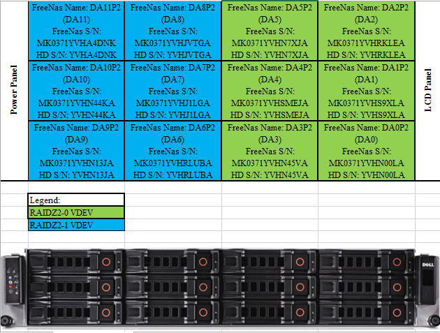

Not going to find it. Initially, I thought along the same lines. I even tried to match up to the actual SAS connectors on the backplane. Then I realized that is not the way to think of things. FreeNas is not tied into a particular controller, SAS connector, etc.; all it cares about is being able to access the drive(s) and basically the Serial Number.
That is what makes it so robust. Switch drives around or even controllers. Heck even switch motherboards. As long as FreeNas can get to the drives directly you are good. Identifiers like da0, da1, etc. can change and are not guaranteed to always be the same (even between reboots).
My advice is to not worry about that so much. Do however note the drive Serial Numbers and where they are physically. If FreeNas tells you a drive has failed, simply cross-reference the serial number to your records and replace the drive. There are other tricks you can do as well, just search the forums.
Here is an example of an older record I created. Even though I added "da0" type info, that was latter found out to not hold true; just the Serial Numbers are all that matters.

Yep you're going to be in for a whole lot more headaches if you try and force this to work the way you think it should. Put the serial number on the outside of the drive bay or make a cheat sheet like Mirfster said.
And like he said switch drives or controllers and everything is good, you can swap them around to your hearts content. Try doing that with a hardware raid card, LOL. Just google "LinusTechTips all our data is gone
