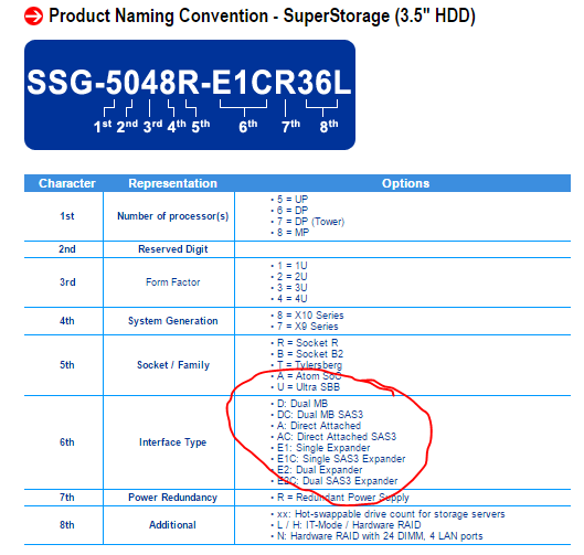

To the OP: please understand that there are multiple configurations of JBOD enclosures. Even in a server, for instance, you can have the following variants:
http://www.supermicro.com/products/Product_Naming_Convention/Naming_SYS_35.cfm
Look for something with the E1 variant. The A variant requires each drive to be cabled individually.
And as for connector type, electrically, internal and external are teh same, and you can buy cables that do what you need. But it's easier to either get an HBA with an external port, or get an adapter (http://www.amazon.com/dp/B00DGFIMQK/?tag=ozlp-20) that converts from internal to external.
