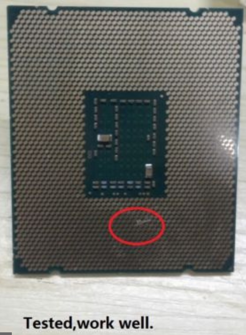

Well the QS Xeon from China fell through, but at least it was a painless process and a very honest seller. :(
The listing said that the CPUs were used, and "Some scratches on heatsink surface but tested working well.". The listing photo showed a picture of a CPU with light scratches on the heatsink. No big deal. that's what thermal paste is for! Unfortunately I bought the last one of 30+ (in fact, first I missed buying the last one, then it got relisted so I snagged it impulsively, now I've come to understand why...)
The next morning I had an eBay message from the seller with a picture of my CPU asking if I still wanted it. They affirmed it was still tested and working, but wanted to clear the damage with me before shipping since it was more than the 'scratches on heatsink surface' I might be expecting. I attached the pic they sent me...
Needless to say, I decided to pass on the chip, as it appears that at least five pads are shorted together. Without a pinout diagram to know what those pins are for I'm not willing to risk the hassle of an unknown CPU. So, back to scouring eBay for a cheap CPU. The only other decent deal I'm stumbled into was an E5-2685v3 QS with retail stepping for around $300-350... It doesn't support HT, but at 12 cores that shouldn't be a problem. I'm trying to keep to a hard limit of $300 on the CPU, but when my only other option is a quad-core 1620 I might be tempted to spend an extra few bucks. Fortunately I have a couple more months to play the field before I need to get this server put together.

Stux
Jun 2, 2016
4,419
That CPU needs to go in the bin
That is a pretty poor quality photo. I can't tell what that smudge is. It could be a glop of heat sync paste. If you think the seller is honest, take his word that the thing works and go for it. I have been a working full time in hardware support since 1996 and the number of CPUs that I have seen fail is probably less than 5. You can actually wash a CPU with soap and water (I have done it) and if you make sure to dry it properly it will still work. They are tough.
I'd stick with alcohol.

It really depends on the price. And then an abused CPU could fail early for any of several reasons.
There's an E3-1230v2 on ebay right now with a corner broken off along with several pads. The description says "memory channel A is NOT working but still working with memory channel B." At $110, no, no way. And not for a NAS. At $20 for a testing system, maybe.

I appreciate the tips but I have to assume it's not just a smudge. At least the seller was up front about it, and they said something like "the metal skin has some scratches", so I assume those 5 pads have some kind of problem.
I do believe them that the cpu works fine, it's just not something I'm comfortable taking a chance on.
Saving money is one thing, but i don't want to set myself up for catastrophic failure down the road... I'll just keep my eyes open for another deal between now and the end of the year.
