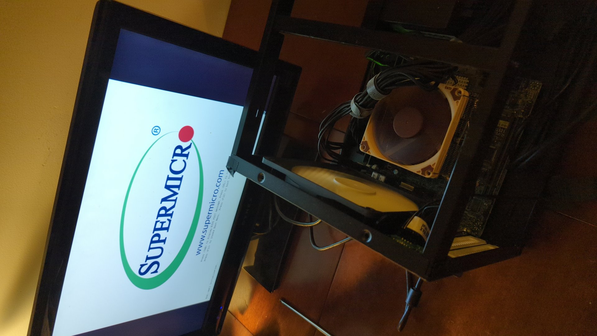

UPDATE 2023/03/23:
I finally decided to swap the motherboard with a new copy. It posted fine. Not sure what was defective with the previous motherboard.
Am I missing something about my parts compatibility? The Supermicro board should support the E2324G and the given RAM....
Symptoms
- I have no post, nor any video output from the VGA port.
- I can enter IPMI, but there is no output from the remote view as well (it literally says No Signal).
- IPMI indicates that I have a healthy E2414 cpu... that's not what I put in!
- IPMI indicates I have RAM, which could be my two sticks. But when I remove a stick, it still says I have two healthy sticks. Is that... normal?
- I tried clearing CMOS, removing components, using either stick of RAM, etc.
- I tried updating the BMC FW. It's currently over 30 minutes that the update is processing... that can't be good, right?
Questions
- Can you sanity check the build please?
- This firmware update... should I just power down?
- Do you think it's more likely the board or the cpu is defective?
Thanks.
