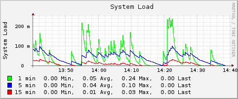

The samba shares were unavailable. I looked at the graphs in the gui and saw that the process count was higher than usual
And when I ssh:d to the machine i found about 1200 instances of smbd on ps -aux

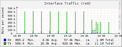

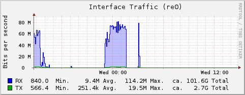

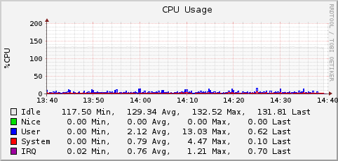

I have attached other graphs.
