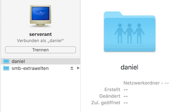

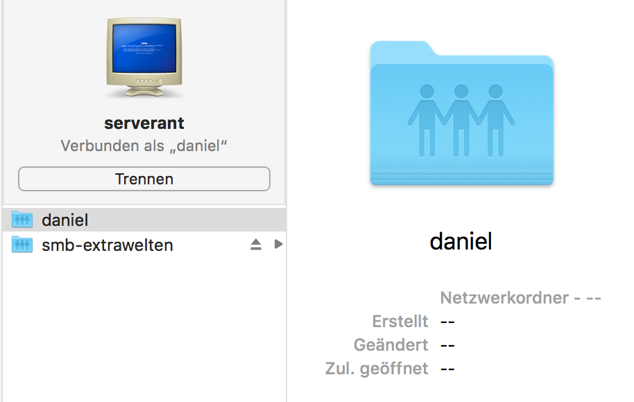

Hello everyone!
I've come a long way with this forum without asking silly questions but now it's getting time :)
I'm using LDAP (Jumpcloud) and have Mac's (10.13.6) accessing my FreeNAS SMB Shares.
At least the SMB-Home Share is not acting like it should as I can't connect to it. Jumpcloud creates the homes to / and from there it's linked to my .../smb-homes
[root@ServerANT ~]# ls -l / | grep -i home
lrwxr-xr-x   1 root  wheel    34 Jan  7 15:33 home -> /mnt/datenTANK_10/shares/smb-homes
lrwxr-xr-x   1 root  wheel    34 Jan  7 15:30 home.g+A54g -> /mnt/datenTANK_10/shares/smb-homes
drwxr-xr-x   4 root  wheel     4 Jan  7 15:24 home.hEhylw
[root@ServerANT ~]# ls -l /mnt/datenTANK_10/shares/smb-homes/
total 2
-rw-rw-rw-  1 root  wheel             0 Jan  7 15:08 .windows
drwxrwxr-x+ 4 root  ldap-xtrw-smbshr  4 Jan  7 16:05 LDAP
[root@ServerANT ~]# ls -l /mnt/datenTANK_10/shares/smb-homes/LDAP/
total 34
drwxrwxr-x+ 2 admin      admin      10 Jan  7 16:05 admin
drwxrwxr-x+ 2 christina  christina  10 Jan  7 15:39 christina
after logging in for the first time a new home is created (daniel)
total 51
drwxrwxr-x+ 2 daniel     daniel     10 Jan  7 16:59 daniel
it's showing up but no access
How do I passthrough all Members of my smbshr-group, do I have to use setfacl and if so how?
I also tried with a WIN-VM with the same results.
I can get access to my Main Shares but it's hard to understand how to handle permissions in this scenario, or is it it just the same as if I was not using LDAP?!
So if you have good advice or links I would appreciate :)
Daniel
