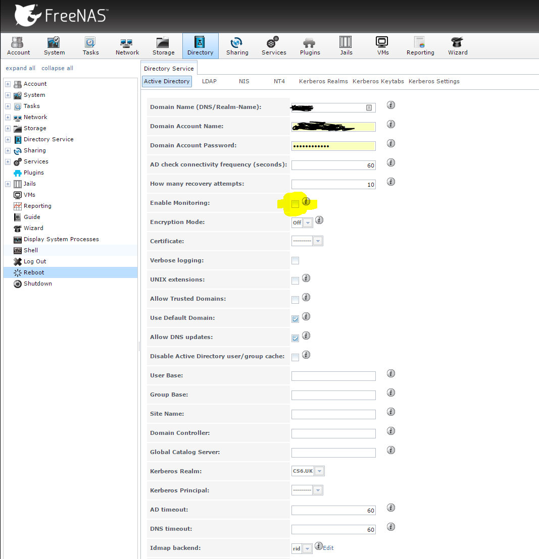

Hi there here is the setting below highlighted in yellow. I had it checked and when I uncheck it the issue goes away. From what I can tell it appears that when the ixActiveDirectoryService attempts to heartbeat with the Domain Controller it fails and ends up cycling SAMBA & AD. Then it comes back but only to cut out again when the "AD Check Connectivity Frequency" value is reached. The max you can set it to is 3600
I can recreate the issue and it appears to clear up by not using the monitoring option.
Happy to do any other checks that anyone is looking for me to do if it helps, I can test this on a baremetal server to do to make sure its not VM related (Doubt it is mind you)

I had disabled it but the errors didn't go away. Changing the interval didn't work for me neither. Strange thing is, I put 6TB of data on this setup by using robocopy over SMB; due to the bottleneck of my previous NAS (old Windows server 2012R2) it transfered at a max of 50MB/s. Now when I try to do a Synctoy operation from my desktop the synctoy operation is hanging in the indexing phase looking for differences. Transfering files using explorer maxes out the network connection and works fine.
Just rebooted with having the health check disabled; no warnings but synctoy still hangs in the indexing part looking for changes. Also browsing with explorer is not possible anymore until I wait about a minute; it looks like Samba is locking itself or something. I hope somebody will be able to analyze logs and get to the bottom of this...
