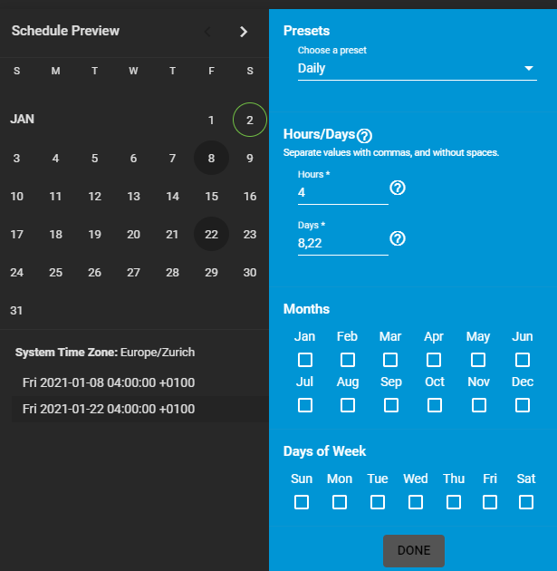

I have it set up like this:
This runs approximately every other week (depending on how long the month is, there can be a two week gap). As far as I can tell, this is the closest you can get.

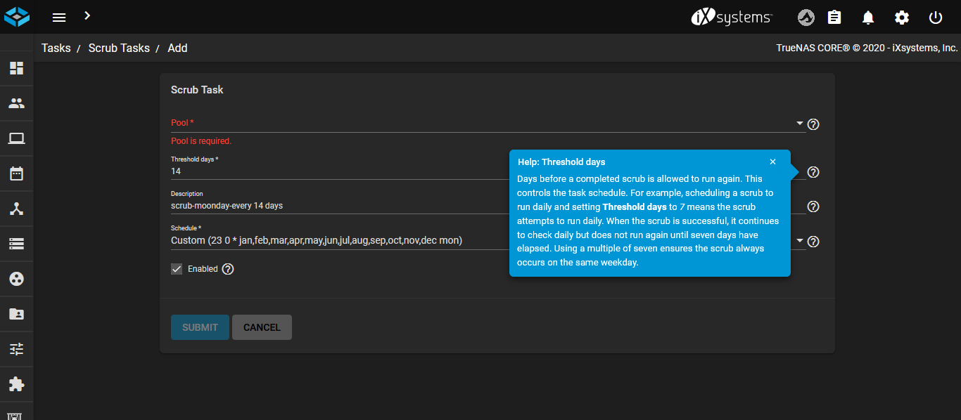

hello
maybe (sure) that screen help
the explanation of threshold IS the "explanation"
cheers
Sadly, Threshold is only available for Scrub Tasks and not for SMART Tests or normal Cron Jobs. So this is not the solution.
