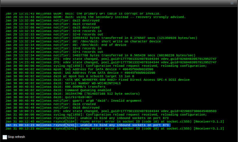

I setup the RSYNC Service to allow another machine to backup to my FreeNAS machine. No problems getting it set up and the initial backup from the remote machine completed without errors. I needed to reboot the FreeNAS machine and now the RSYNC service with not start. I get the following errors:
Dec 16 19:44:20 saifs rsyncd[12872]: unable to bind any inbound sockets on port 873
Dec 16 19:44:20 saifs rsyncd[12872]: rsync error: error in socket IO (code 10) at socket.c(555) [Receiver=3.1.3]

Did this got a bug ticket? Getting the same on 11.1-U7.

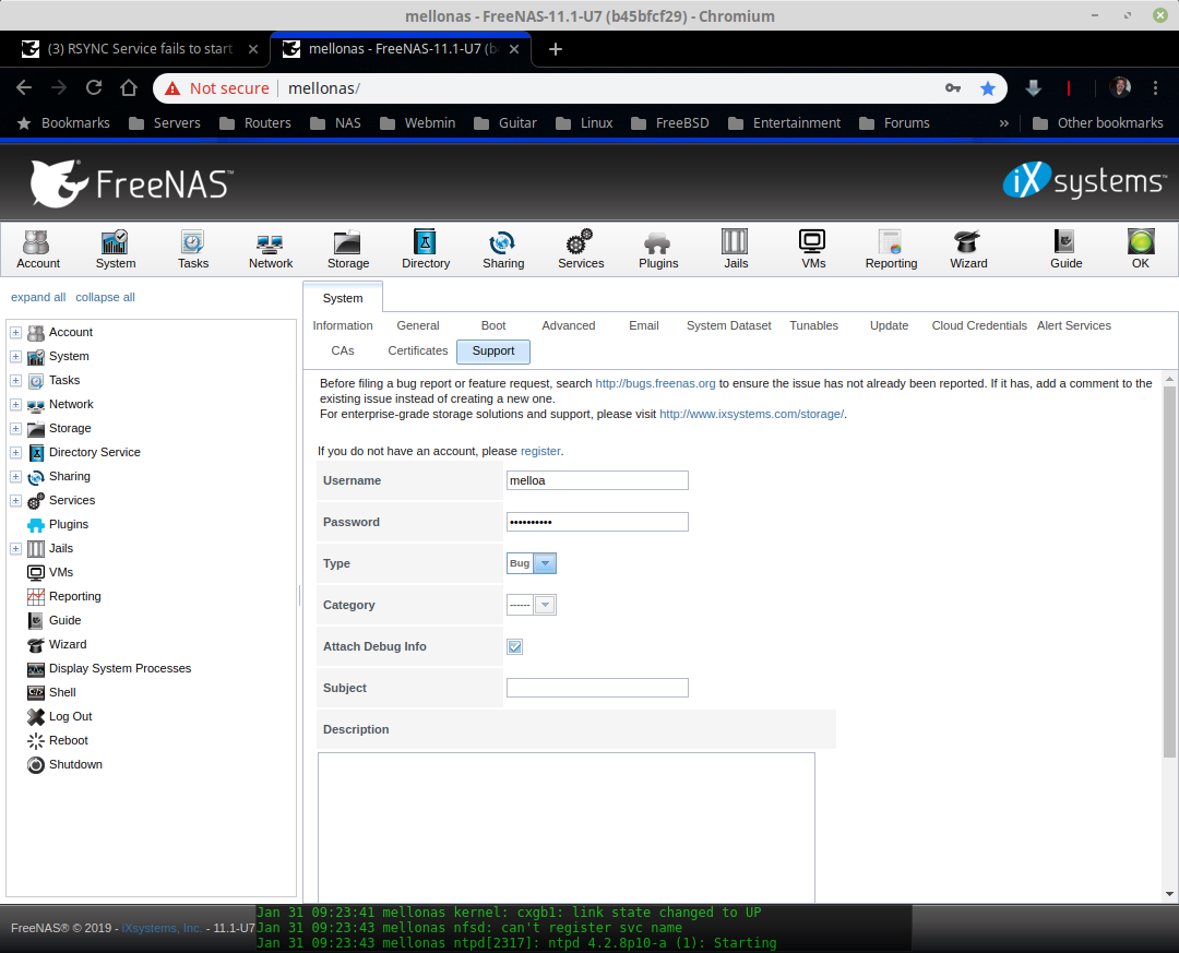

Not working from the GUI - maybe new link to bug site is incorrect?
Before filing a bug report or feature request, search http://bugs.freenas.org to ensure the issue has not already been reported. If it has, add a comment to the existing issue instead of creating a new one.
For enterprise-grade storage solutions and support, please visit http://www.ixsystems.com/storage/.
If you do not have an account, please register.
I think the new url is https://redmine.ixsystems.com/
