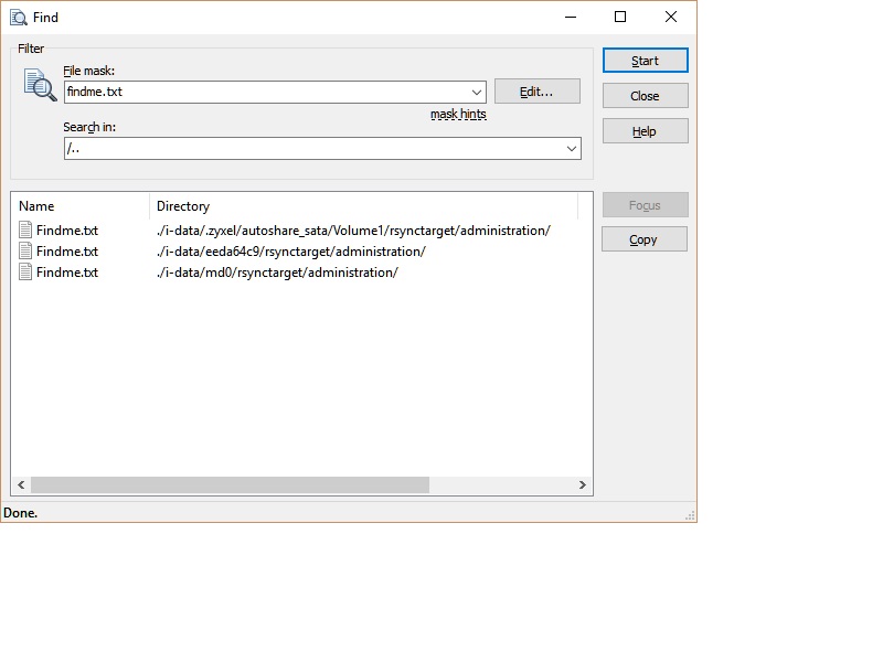

I made a last attempt this weekend to get things going before playing around with FFP. I used WinSCP to take a good look in the file system of the Zyxel NAS. I created a share called rsyntarget and in that share I created a folder called "administration". Within this folder I created a file called "findme.txt". This way I should be able to find the file with WinSCP or on the commandline with a grep command.
I started with a search with WinSCP and soon the file was found trough 3 different paths! See screenshot1. Two of those path contained shortcuts (the first and third path). Only the second path seems to be valid. If I used the first or third path in the task I got a "invalid path warning" when saving the task. When I used the second path it was accepted without error and the task could be saved.. However, still no joy. Running the job was without result. But a log file was written and it looks like it will be FFP after all, because this text was in the logfile:
2017/07/09 16:02:40 [47763] rsync: connection unexpectedly closed (0 bytes received so far) [sender]
2017/07/09 16:02:40 [47763] rsync error: remote command not found (code 127) at io.c(226) [sender=3.1.2]
Looks like one way rsync support to me (from and not to the NAS).
