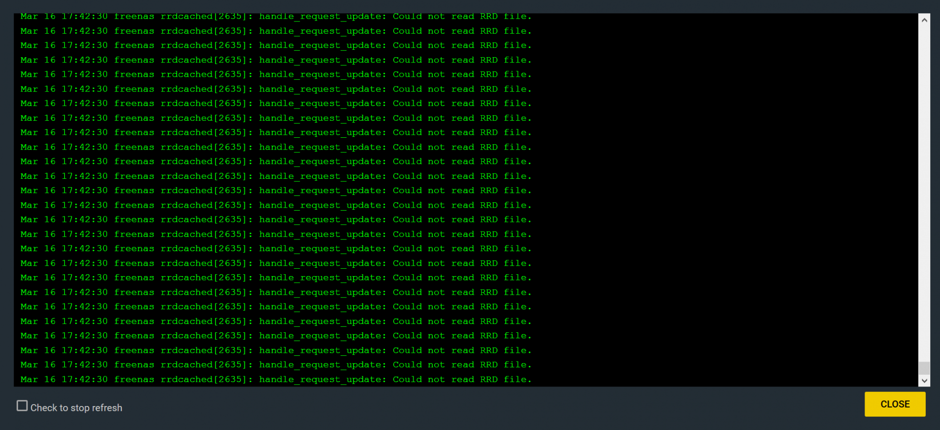

Hey everyone, so I just updated from FreeNAS>9.2 to current FreeNAS (FreeNAS-11.2-U2.1 ), and everything in the update went smoothly except for one weird thing that is now spamming my terminal:
Mar 16 17:32:50 freenas rrdcached[2635]: handle_request_update: Could not read RRD file.

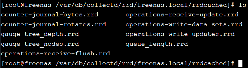

This has completely taken over my terminal, as it just spams the message non-stop. The system seems to work as normal. Aside from the spam, there doesn't seem to be any problems. I did a good amount of searching where I could and couldn't find anything. After some snooping I found the rrdcached folder in the `/var/db/collectd/rrd/freenas.local/rrdcached/` path, and it contains the following files:
  • counter-journal-bytes.rrd
  • counter-journal-rotates.rrd
  • gauge-tree_depth.rrd
  • gauge-tree_nodes.rrd
  • operations-receive-flush.rrd
  • operations-receive-update.rrd
  • operations-write-data_sets.rrd
  • operations-write-updates.rrd
  • queue_length.rrd
Am I perhaps missing one? Should I replace one?

Was that done in one update or several (eg 9.2 -> 9.3 -> 11.0 -> 11.1 -> 11.2)? If it was one, a change in RRD didn't get migrated.
What is the output of ls -l /var/db/collectd/rrd/freenas.local/rrdcached/ ?

The output of this command is:
# ls -l /var/db/collectd/rrd/freenas.local/rrdcached/
total 1332
----rw-rw-  1 root  wheel  148648 Mar 19 20:29 counter-journal-bytes.rrd
----rw-rw-  1 root  wheel  148648 Mar 19 20:29 counter-journal-rotates.rrd
----rw-rw-  1 root  wheel  148648 Mar 19 20:29 gauge-tree_depth.rrd
----rw-rw-  1 root  wheel  148648 Mar 19 20:29 gauge-tree_nodes.rrd
----rw-rw-  1 root  wheel  148648 Mar 19 20:29 operations-receive-flush.rrd
----rw-rw-  1 root  wheel  148648 Mar 19 20:29 operations-receive-update.rrd
----rw-rw-  1 root  wheel  148648 Mar 19 20:29 operations-write-data_sets.rrd
----rw-rw-  1 root  wheel  148648 Mar 19 20:29 operations-write-updates.rrd
----rw-rw-  1 root  wheel  148648 Mar 19 20:29 queue_length.rrd
