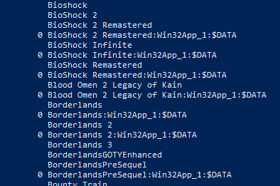

Found that the directories in question all had an Alternate Data Stream that was a 0 byte file; all Win32App_1

There was zero-length ADS on source directories? What is output of Get-Item <filename> -stream * on source Windows box?
On any of the directories that would fail to copy.
If I created a matching directory on the truenas box, then ran robocopy again, it would delete that directory as well.
I found them doing a dir /r, let me get that info and post it; have to boot the server again.
get-item 'BioShock 2 Remastered' -Stream * does not produce a result. get-item 'BioShock 2 Remastered' does return a result so that selection is viable.
