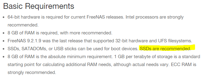

Hrmm - the docs say USB sticks are fine:
The FreeNAS® operating system is installed to at least one device that is separate from the storage disks. The device can be a SSD, USB memory stick...
In fact, the screenshot you posted says the same thing and that SSDs are only recommended. So I guess I'm confused. If USB boot devices aren't recommended any more then why are they listed all over the place in the docs?

Oh and again, we don't have a choice about hardware. This is what we have to work with. I'd have never used USB boot drives if we had a choice or if the docs had said not to.
