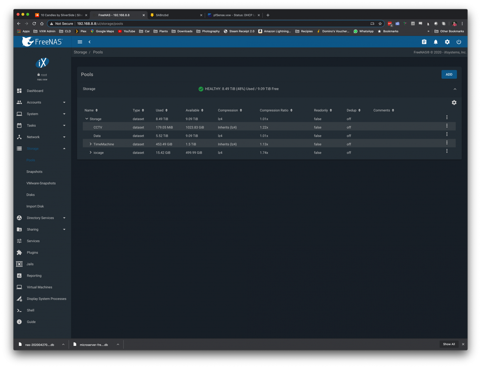

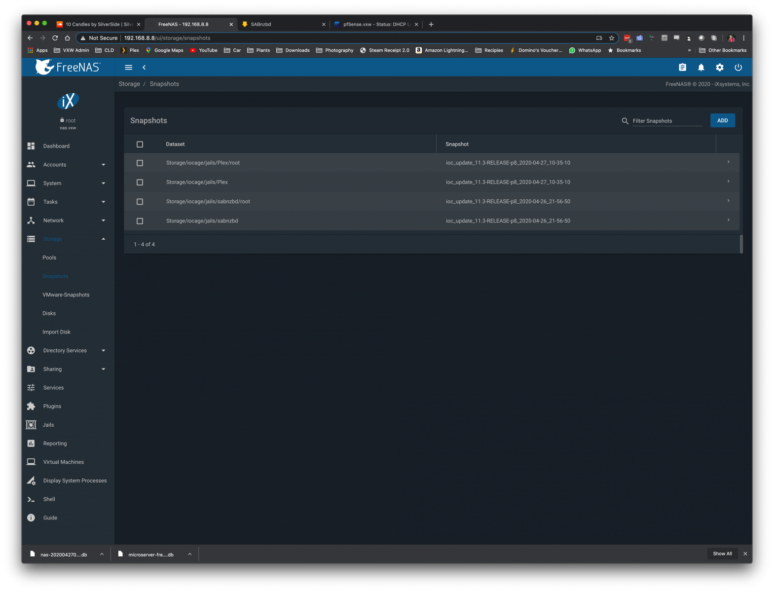

After a little but of help as to what to do here please!
Ended up replicating my 2-day old proof of concept NAS to a new machine after a drive failure on the machine everything was being copied from, so I decided to dump 3x10tb discs in the original server and set up FreeNAS again.
Now, exactly what happened in the restore is honestly a little hazy because I was running on very little sleep. I somehow ended up with 2 copies of my restored data, one of which was removed (an appeared not to be as a result of the snapshot - but who knows)
Anyway!
I've removed the snapshot since the replication is complete and the data is in place, all working as I'd hope and expect. However, right now, the Pools page shows 8.47TB usage.
Storage                                                   8.49T  9.10T  2.51T  /mnt/Storage
Storage/.system                                           20.3M  9.10T   128K  legacy
Storage/CCTV                                               179M  1024G   179M  /mnt/Storage/CCTV
Storage/Data                                              5.52T  9.10T  5.52T  /mnt/Storage/Data
Storage/TimeMachine                                        451G  1.50T   117K  /mnt/Storage/TimeMachine
Storage/iocage                                            15.4G   500G  6.18M  /mnt/Storage/iocage
Storage/iocage/download                                    289M  9.10T   117K  /mnt/Storage/iocage/download
Adding up what's in use comes to ~6TB
My replication was ~2.54TB
It feels as though with some compression, that difference is the remainder of some replication data somewhere? I removed the snapshot after import, but is there anywhere else this is likely to be? I obviously don't want to lose out on my 2.5TB! Ran a scrub task on the drive too - thinking a scrub task probably does what it sounds like to no avail.
Any ideas? I really have no desire to start again and figure this must be pretty simple for someone who knows what they're doing
