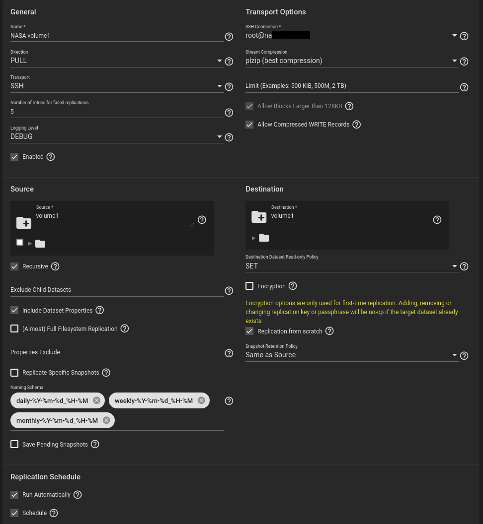

The last line continues with a string of alphanumeric characters, ending in '..'. The console log around the time the mail is sent shows nothing. Settings for the replication task are below.
