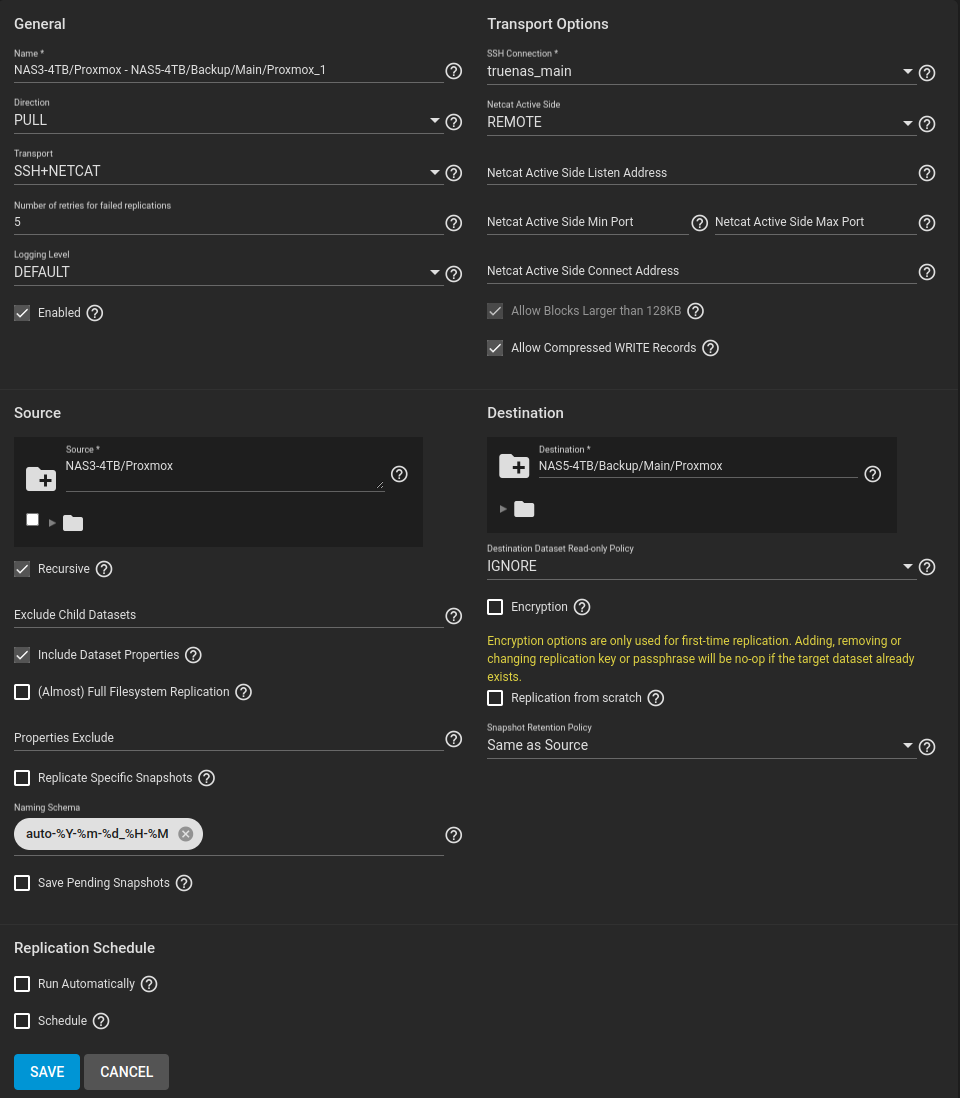

I got two instances of TrueNAS 13 set up fresh (1st for 4 weeks, 2nd for 2 days). Im trying to get the Replication Tasks of Snapshots running but it drops an error.
My setup:
I did it like in a tutorial for TrueNAS 12 because i couldnt find a 13 tutorial.
When i start the Task, it sends up to 10 GB (~1%) sometimes and then it drops this error:
My setup:
