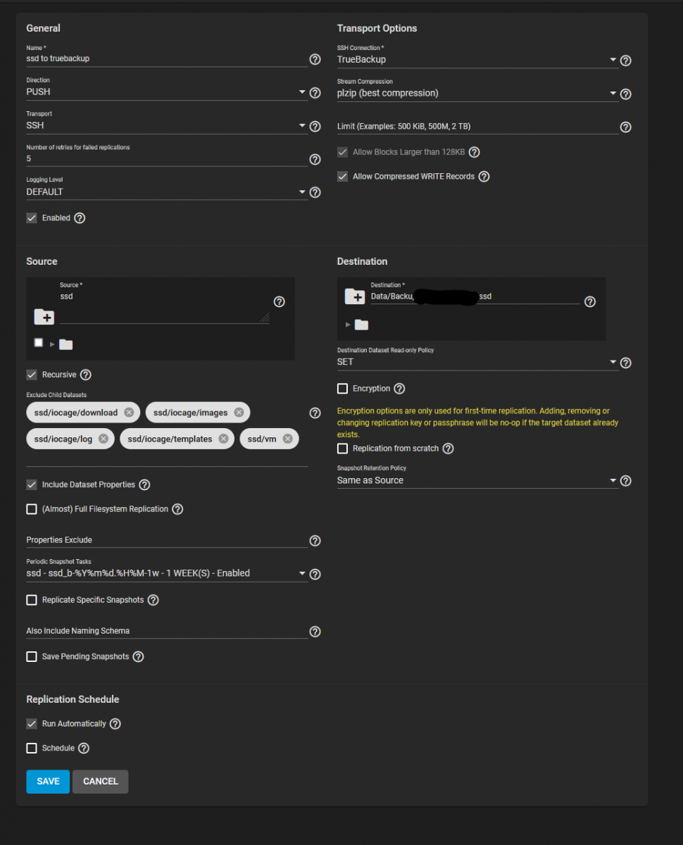

my replication settings:

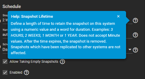

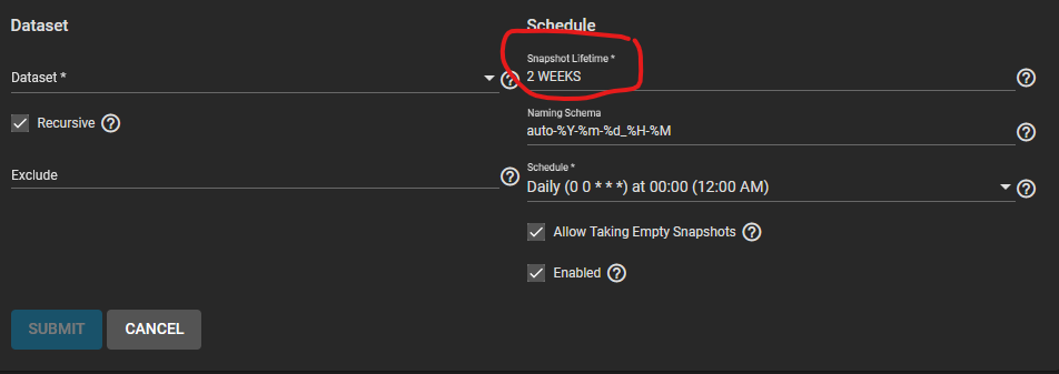

I think this is what he is referring to, but again... it's snapshot terminology, not dataset.
Also, this does NOT apply to snapshots that have been replicated to other machines as indicated in the last paragraph on the screenshot below.

I didnt see the option in GUI and "replication from scratch" doesnt seem to help ether.
Prob my best option is to write manual replication commands with recieve -F and run them manually once in blue moon.

I think what you need to do (delete datasets that don't exist on the source system) requires the -R command on the sending side. On the GUI, I believe it's the "(Almost) Full Filesystem Replication" option.
