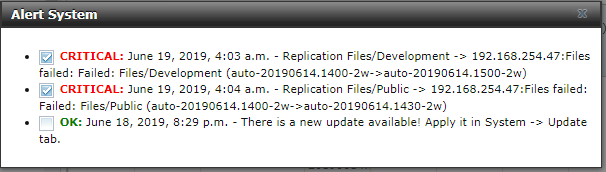

Here is the alert email I receive:
"Hello,
The replication failed for the local ZFS Files/Development while attempting to
apply incremental send of snapshot auto-20190614.1400-2w -> auto-20190614.1500-2w to 192.168.254.47"
"Hello,
The replication failed for the local ZFS Files/Public while attempting to
apply incremental send of snapshot auto-20190614.1400-2w -> auto-20190614.1430-2w to 192.168.254.47"

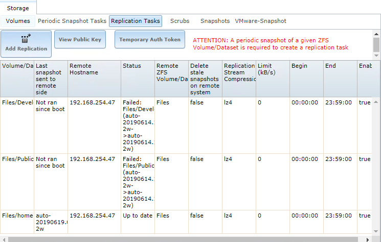

'Not ran since boot' implies the primary system has been rebooted recently, does that sound right?
As the amount of data in Files/Development and Files/Public is so small I'd be tempted to remove all related snapshots to these datasets on the secondary system and then just let replication start afresh and sort itself out (which it's very good at doing).

Uptime 9:07AM up 1 day, 19:21, 0 users
The secondary also hasnt been up that long. Perhaps you were rebooting the servers to troubleshoot?

Looks like "destination already exists" is the error. What could be the cause of that? Anyway to avoid it happening again in the future?
Be worth looking to see if the secondary already has a snapshot with that name/date/time as the error suggests its trying to send a snapshot that already exists.

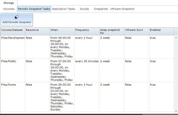

The snapshot does exist on the secondary server. Could it be because there are also snapshots being taken on the secondary server?
Jul 3, 2015
926
Shouldn't be but you can check that in the scheduled snapshot section.
Assuming not it could have just got its knickers in a twist for some reason.

There were "Periodic Snapshot Tasks" configured on the secondary server. I destroyed the snapshots for Public and Development, and disabled the snapshot tasks on the secondary server. I will report back how it goes over the next few days. Thanks for your guidance!
Ah, that could well be your issue then. Best of luck
