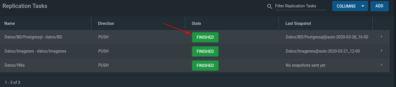

Hi, I'm trying to execute a Replication Task from one server to another vía SSH, everything configured from the 11.3-U1 user interface.
The replication finishes with error, but it's not clear what the error is. Can you help me determine the error?.
When I click the red error button (see the screenshot below), the error message is this:
Error
Logs

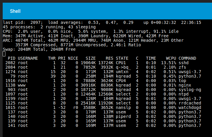

I deleted the dataset from the target server, then manually started the replication (by clickon RUN NOW button on Replication Tasks), but it rebooted the target server again. This time I was running top trying to see somethin interesting, but I don't see nothing special, here's the screenshot:

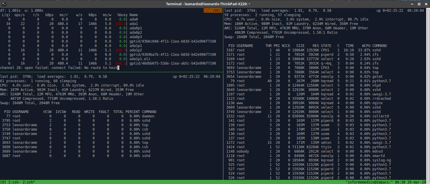

This morning I've executed gstat, top, and top -m io to watch the io, cpu and memory at the moment of reboot, here's the screenshot.
