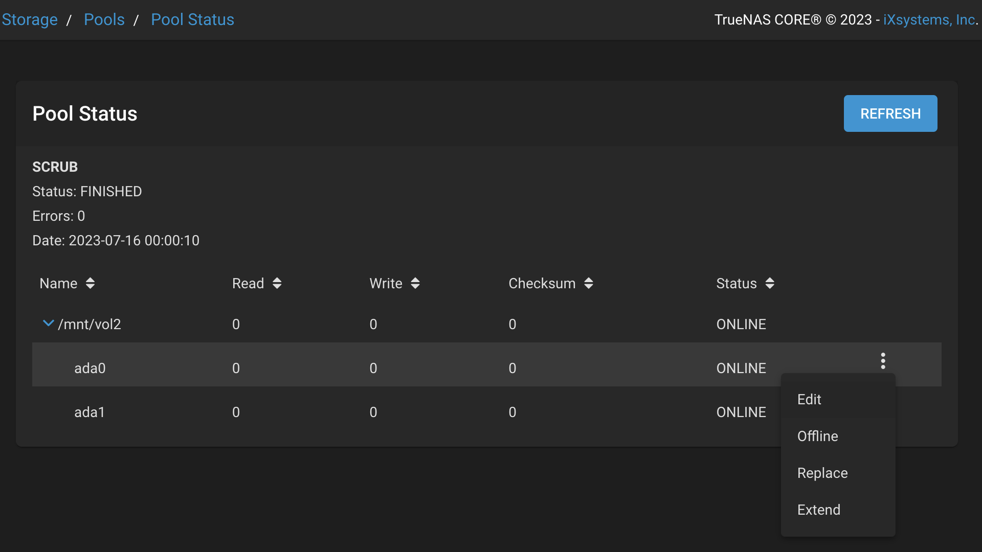

OK, well the documentation for this is missing completely at this point and I have exactly that same job waiting to be done at some point, so I'll take a couple of screenshots for you...
Storage | Pools | Cogwheel for that pool | Status:
Actually if you're paying attention this pool isn't already a mirror, but you can do the same thing with a mirror anyway...
3 Dots on one of the disks, then Extend.
Pick your new (larger) disk.
Let it resilver.
Do that again with the second one, then come back and Detach one, and then the other old one.

One thing I would add/note having done that yesterday is that at the beginning, it just kind of sits there looking like it's not going to work... but if you're patient and just trust that it will eventually get there, it does.
General advice, patience and slow action is key, don't rush anything with ZFS.

What I was in the middle of doing there was converting it from a stripe to a mirror (while increasing the size of the disks).
I had been using that pool for jails, so was satisfied that the loss of it would be easy to recover (by just re-creating my jails) since I don't store any data in the jails themselves. (and I back up to another pool which does have redundancy for the bits that matter in that pool).
