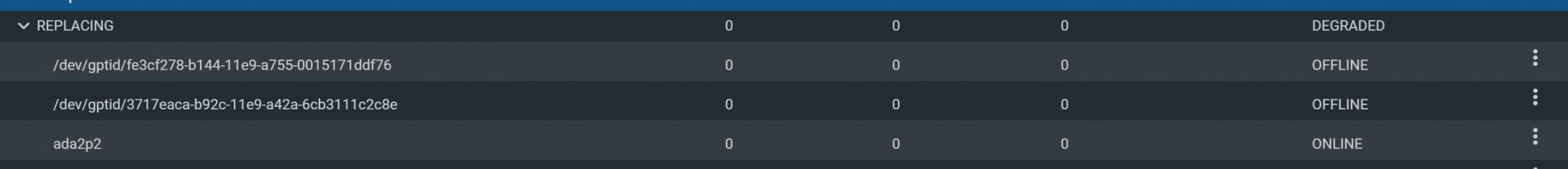

HI. I have a 1TB (Part of an 8 Drive Array) and I tried to replace it, the re-silver failed with the box hanging, I rebooted it and there was no mention of resilver and the drive was offline. I tried again and the same happened, however I now have the drives listed below. I have tried to detach the drives with zpool command but the box just freezes then restarts with the same degraded pool. Are then command I can run to remove the drives and add the new ada2 back to the pool?
Thanks

Why have a got 2 guid replacements, as per the attachment above?
