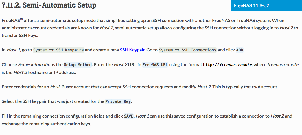

In System → SSH Connections → Add the Setup Method is “Semi-automatic (FreeNAS only)” by default. But I have no clue how that's supposed to work. The manual at https://www.ixsystems.com/documentation/freenas/11.3-U2/system.html#ssh-connections doesn't really help either:
Hostname or IP address of the remote FreeNAS® system. Only available with Semi-automatic configurations. A valid URL scheme is required. Example: https://10.231.3.76
Why URL and https? It's SSH, there is no http involved. Is it maybe the URL of the web GUI of the remove system? The web GUI is not publicly accessible and I do not intent to open the web GUI to the Internet.
Maybe someone can shed some light onto this mysterious semi-automatic configuration and its URL.

It doesn't? This doesn't explain what's going on?
(see https://www.ixsystems.com/documentation/freenas/11.3-U2/system.html#semi-automatic-setup, which is linked from the link you gave)
15,504
Which URL?
It tells you: http://freenas.remote, where freenas.remote is the Host 2 hostname or IP address. What part of that is unclear?
And it doens't explain why http?
No, the manual isn't a "why to", it's a "how to." The "why" is presumably because you call the API via http, not ssh. I'd expect it would work over HTTPS as well, but I can't say that I've used it.
The unclear part is the http part. This is about an SSH connection and there is not http server listening on that host, which is why I'm getting an error message if I try to use http (which is expected).
The web gui and API use http (or https for that matter), true. But neither is exposed to the internet, only SSH is exposed. I don't know how one could reach a remote server without exposing the gui/API to the internet. And the manual does not suggest opening any additional ports.
If I exactly follow the manual I get an error message, which is expected because there is no http server listening.

15,504
There's the internet between host 1 and host 2 (as mentioned in the OP)
No, this wasn't mentioned in your OP. Maybe you meant to, but you didn't. What you said was:
...but you never said why you believed that fact to be relevant. Perhaps you meant for the reader to infer that for it to be publicly accessible and open to the Internet would be the only way that host 1 would have access to it, but that's hardly the same thing.
Neither the GUI nor the manual mention that the semi-automatic mode only works for trusted networks which have access to the gui/api, so I assume this is not the case.
But you assume incorrectly, and if you take a minute to think about it, this is obvious. The "semi-automatic mode" semi-automates configuring a SSH connection. That means the SSH connection isn't configured yet, which means that it can't be done over SSH--it must be done through some other channel. I guess this doesn't prove that the "other channel" needs to be http(s), but when the manual literally tells you in two different places to use a http:// URL that should be a bit of a clue.
Maybe the docs could be clarified on this--file a bug against them if you think so.
That's why I was asking in the first place how this is supposed to work. So the answer is: It uses the API, making it unsuitable for remote hosts and was probably designed for other freenas hosts in the same or another trusted network where the API is accessible.
In this case I'll use the manual SSH setup rather than the semi-automatic. Thanks for your responses.
