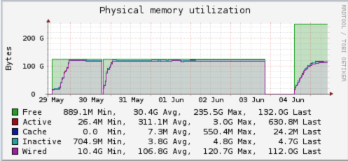

I suspect my 'small' home server is reaching the point where I need to start tuning some settings, it looks like it hasn't correctly configured itself for the recent RAM upgrade it received. Before I go fiddling - any advice of war to tune and what to leave alone. Id rather not get involve din auto-tune, i'd prefer to understand whats being changed and why.

That image looks like you just now booted the server? Usually you have to run FreeNAS under load for several days to see how memory ends up being used.
Is it possible you have more RAM than you really need!? I didn't know such a thing was possible with ZFS! :)
wtfR6a
Jan 9, 2016
88
Its been up for a paltry 12 hours under somewhat moderate use although I would have expected ARC use to continue to rise until free RAM was consumed. Strikes me as odd that it tailed off as its approached the previous max of circa 100GB of 128GB fitted.

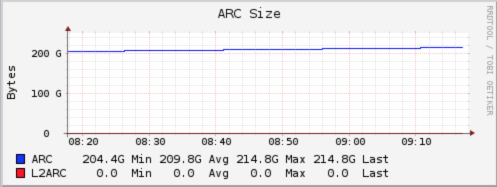

Thanks for the feedback jgreco. Im sure the working set is larger than 100GB as its currently a ~30TB dataset with fairly random access patterns so I would have expected some additional caching overnight however its ruler flat. I'll let it soak over a few days and see how it progresses.
I've never touched auto-tune for fear of the FreeNAS gods raining down on me so theres definitely no old settings hanging around in there.
Heres the seemingly important sysctl's
vfs.zfs.arc_max: 266604064768
vm.kmem_size_max: 1319413950874
vm.kmem_size: 267677806592
and dashboard stats of this morning.

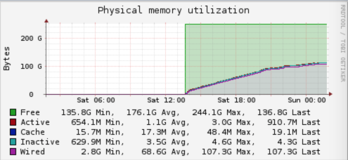

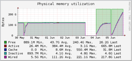

wtfR6a
Jan 9, 2016
88
the reboot gods fixed everything.....same sysctl's but different results.
