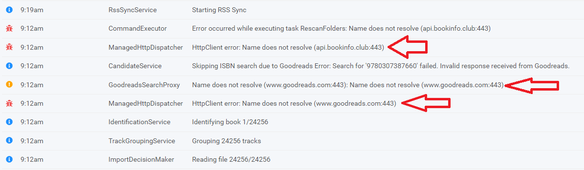

I installed Readarr and the first Calibre library (yes, I linked Readarr with Calibre) was successfully imported.
Now I'm trying to import 4 more libraries, but I started to receive weird error messages:
I said "weird" because I'm able to ping/resolve all these URLs inside the jail, through command line. It can be through my DNS or even through /etc/hosts, my network is working fine. But for some reason, Readarr app does not.
I tried to get help through Readarr Discord, but they said, essentially, that as I'm using a "niche OS", I'm on my own... I need to support myself. Something like this...
Does anybody knows what is the cause of these errors?

first of all: Nice work getting a rough outline of getting Readarr working! :)
I don't have a guide for it yet as its still in the "nightly" phase and would be a rather fast moving target for a guide as things might change quicker than I can react on updating a guide.
Cert errors:
make sure `openssl` is installed along with `ca_root_nss`
make sure it is not using the now-expired Let's Encrypt root cert as you may have to delete it. If you need to connect to a site that uses VeriSign's old root cert you will need to remove it from the blacklist.
Here is where things get odd:

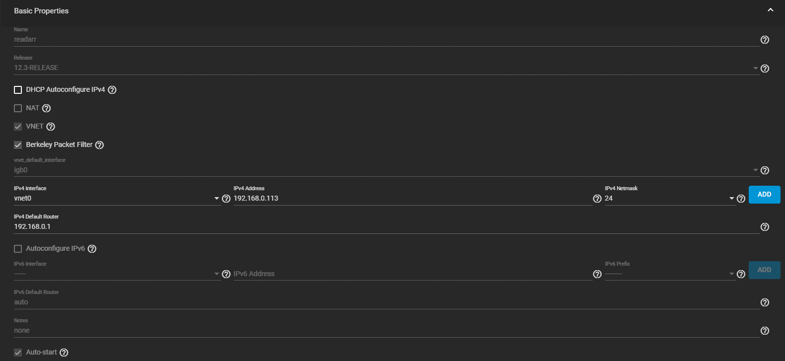

Do you have ipv6 enabled for the jail? If no, you need to either a) be running the jail with `VNET=on` AND/OR `ip6=inherit`. If yes, make sure the ipv6 stack is working correctly and double check firewall rules.

Jun 4, 2017
163
Hi!
Thanks for reply.
1) openssl and ca_root_nss are installed. How do I check if they are using Let's encrypt root cert?
2) IPv6 is not enabled. Actually none of my jails has IPv6 enabled.
3) VNET is enable. Actually all my jails uses VNET.
Is there anything else?
Thanks.

I guess that both addresses returns ok, but I don't know to evaluate them properly.
Would you mind to check them, please?

both of those look fine. can you make and attach trace logs? you can remove things like API keys
Here is the one of the log files with trace enabled.

I think the port for Readarr is 8787 not 7878

well, im confused. it looks like it can connect out to other services (like nzbhydra in another jail?) but its having issues with public addresses that require resolution.
Readarr is still in nightlies and this might be a known issue that will get resolved in a future release. The last few things that you might want to try is setting `DOTNET_SYSTEM_NET_DISABLEIPV6=1` when launching Readarr and/or if possible, using an IP address for any address you want it to connect to.
