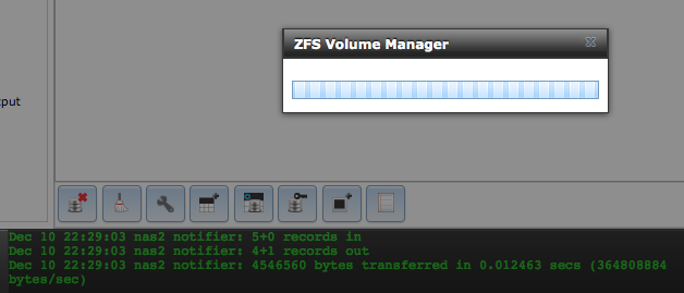

Here, footer show nothing after dd results. In CLI, hangs at zpool add -f poolName cache /dev/gptid/...
Your SSD cache is "full 4K compliant" ?! ;-) More seriously, maybe it has to do with our yesterday conversation... Remember ?
Xaro
Dec 9, 2013
7
Screenshot is the only info I can provide in that situation.
If have time tomorrow, I will try with another device as cache.
