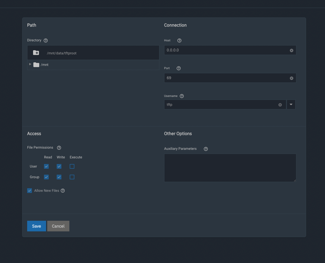

I am struggling with TFTPD on my Truenas. I have tested tftpclients on different systems (mac, debian, windows) and all fail with the same error
The setup:
i tried also with nobody user
The Directory /mnt/data/trftproot has been tested with: 773, 772, 777. always the same error
owner has been updated to nobody:nogroup or tftp:tftp (according to the service owner)
an example of the error (i get with any system)
root@router:/config# tftp 10.10.0.200 -l config.boot -r config.boot -p
tftp: server error: (2) File must have global write permissions
The problem is under the umask used on tftpd. Basically the umask is not fully modifiable by the Webint, especially the OTHER user is missing.
The command running is:
/usr/sbin/in.tftpd --listen --user nobody --address 0.0.0.0:69 --secure --create --umask 002 /mnt/data/tftproot
command should become for writting to work
/usr/sbin/in.tftpd --listen --user nodoby --address 0.0.0.0:69 --secure --create --umask 005 /mnt/data/tftproot

@Samuel Tai, I do not agree. Typically you do not need to touch and chmod a file using tftpd! otherwise TFTPD would be useless for all the routers, switches and other systems requiring this.
tftpd-hpa does this for you, and the umask is there to enforce this `g+w` if set correctly, reading the last lines of my message shows exactly where the implementation issue is lying.
The umask is configured by the service itself, and it seems that umask is not updated on /etc/defaults/tftpd-ha, but the file is rewritten every time tftpd is restarted or configured.
Further seen umask stay at `002` while with my configuration should be at `115` I believe is still a bug during the update/creation of the config file.
A bit more supporting evidence of a bug is the `midclt` is doing it's job but webui!? probably not and still this 5 in the end is really needed to be the default other flag
