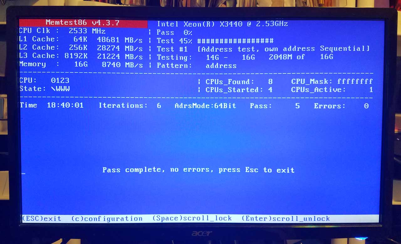

I'm testing my ECC RAM at the moment. I've been running Memtest86 for a while now just to let it do it's thing. So far I'm on pass #5 after 18+ hours or so and it reports 0 (zero) errors. I had to run an older version (V4) because it's an old board (X8SIL-F) that doesn't support UEFI booting.

Even if the ECC isn't being tested (which I understand it is not here specifically), shouldn't the error show up in Memtest in some way? Odd that the board reports an uncorrectable error, yet the Memtest is ok with it?

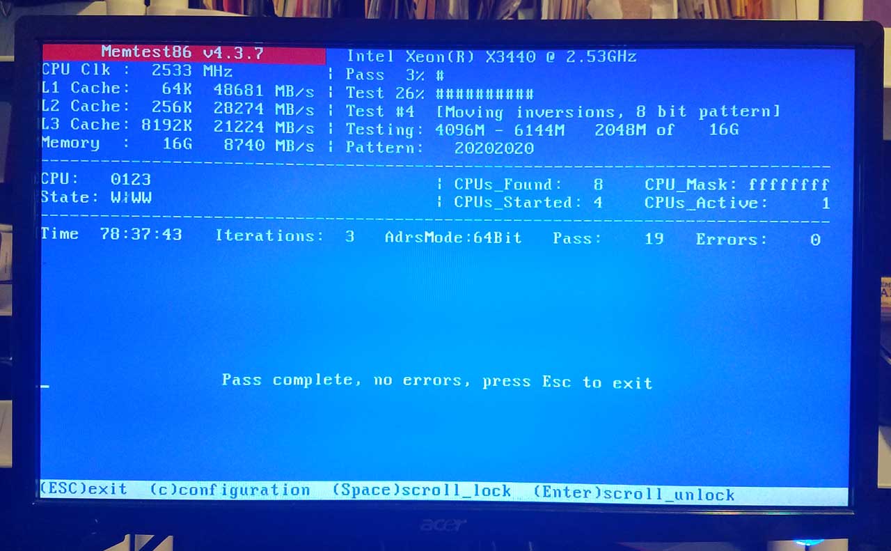

I finally stopped testing the RAM. I'm at over 78 hours of non-stop testing in MemTest86, 19 total passes, with zero (o) errors reported so far. The only error I saw reported was the one I posted above from IPMI alerts, but it has not happened again.
Would you all say this is worth using, or should I still be worried about the error message from IPMI or was it merely a translation error and really is corrected being that MemTest reported no errors?

I’d say you’ve pretty well burned in your RAM, and it’s ready for service.

I'm still of course worried about why it said "uncorrectable" in my IPMI event log instead of "correctable" or something. Yet MemTest reported zero errors. So I'm agreeing that it's probably a translation thing since it didn't happen again. I'll just keep watch and if it occurs again, I'll get new RAM. So I guess I'm going to go forward for now.
