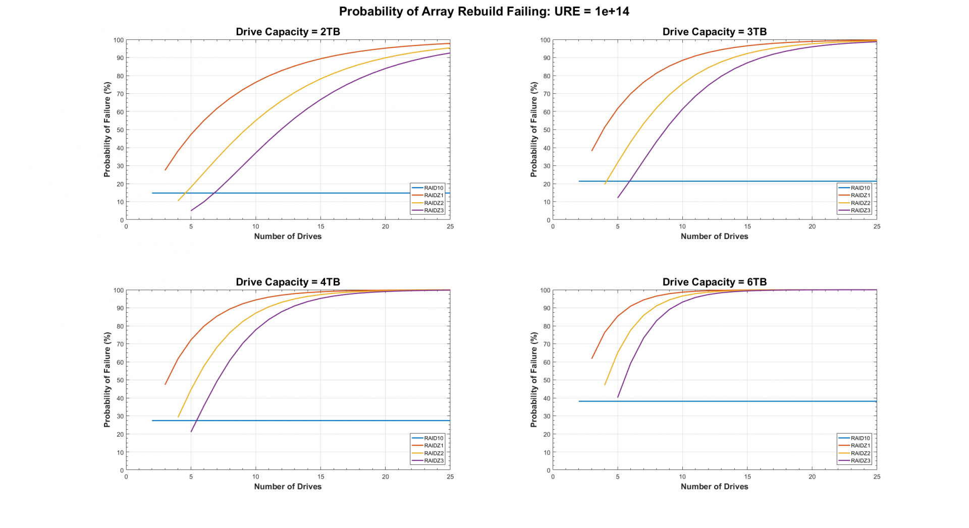

As for RAIDZ1, from my calculation, depending on array size, it doesn't matter. The chances of the rebuild encountering a URE after a drive dies is pretty high if the array is too large. Eight 4TB drive in RAIDZ2 has ~75% chance of failing a rebuild.
