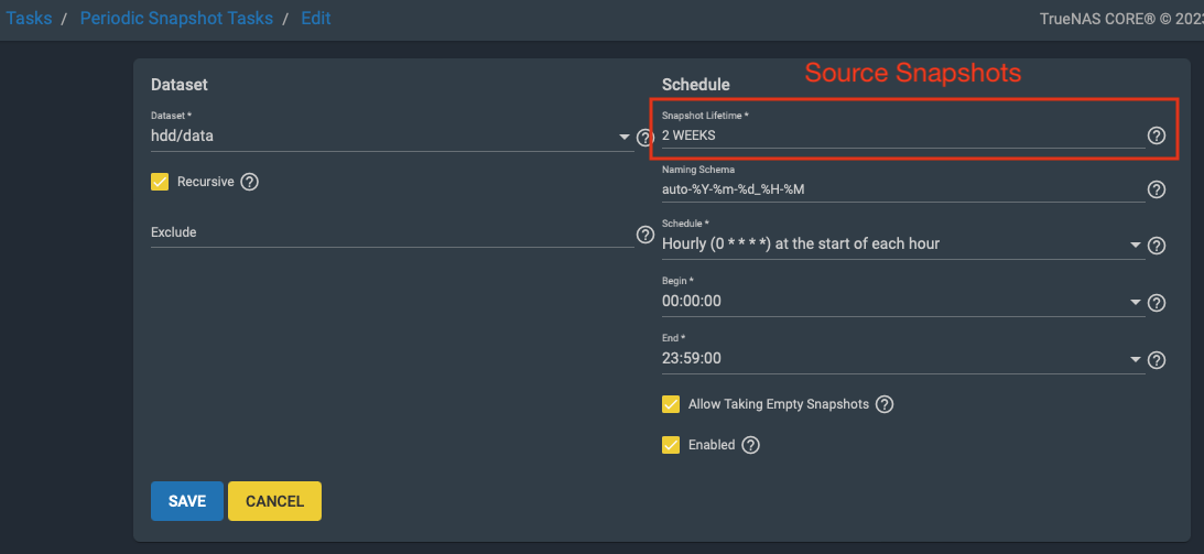

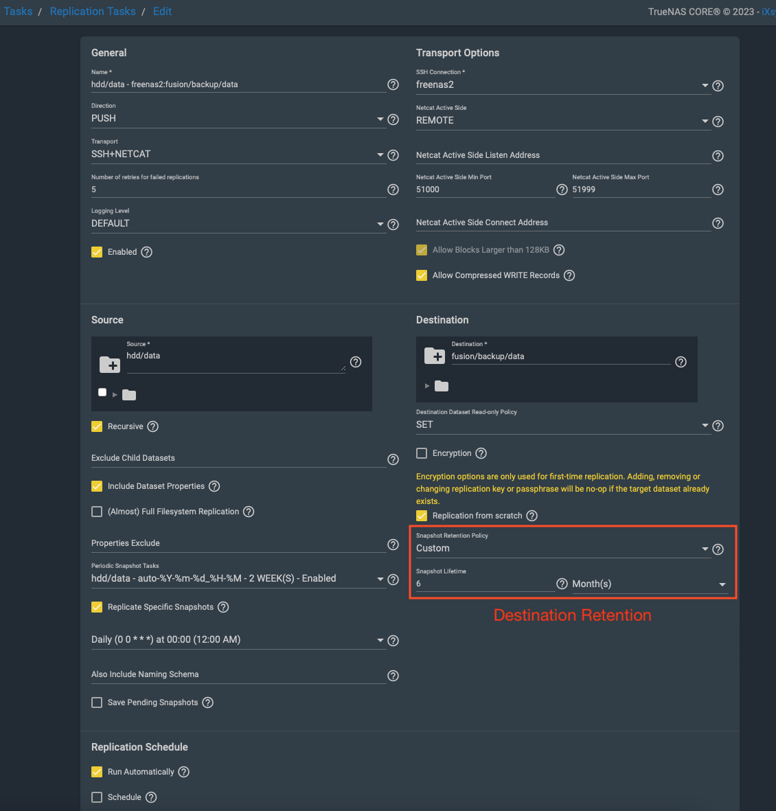

Patrick M. Hausen
Nov 25, 2013
7,776

Ok. Thanks. Mine are set to "Same as Source" and the retention period for replicated snapshots is 8 weeks. Since I am in a bit of a space crunch on the SSD pool, I just want to make sure that that if I manually delete snapshots on the source, the remote snapshot won't go away the next replication, as I thought that I read somewhere that that was how they normally worked.
Patrick M. Hausen
Nov 25, 2013
7,776
It does work like that if you set "same as source". At least I think that "same as source" implies "delete all snapshots not present on the source." One would have to check the source code to be sure.
So to be safe define a custom retention policy and the system will use that.
