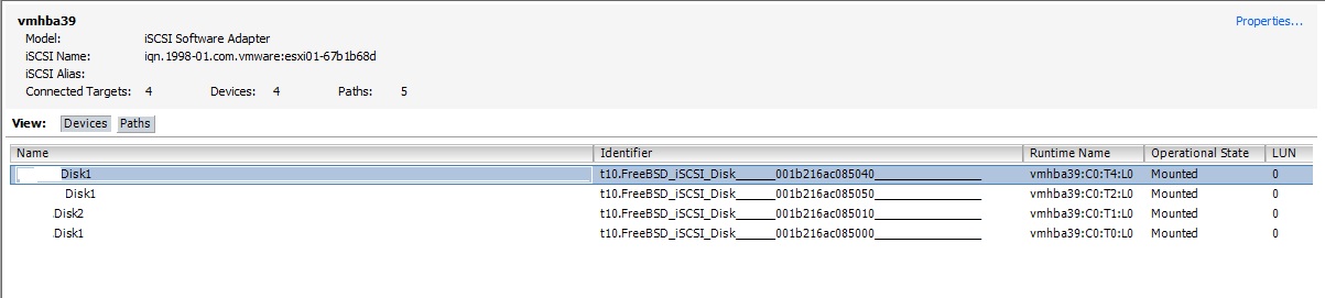

Thank for the reply. I plan to add multiple paths in the future, but now I only have one path. The paths I'm referring to is shown below:
My terminology is probably all wrong but here's the deal. I added four disks, started iSCSI. Everything seemed to work. I added another disk and it didn't show up. Before I figured out that I needed to restart the iSCSI service, I added one of the drives that was named for use on a virtual machine to connect to ESXi to use only to store VM settings. Once I figured out the service thing, I wanted to have the disks correspond correctly to the machine they would be used for, so I unattached the drive from the ESXi host and added it to the correct VM. When I did that, the VM said I couldn't install windows because the disk was unbootable (had been formatted for ESXi).
Although I'm sure there was a better way to do it, I just deleted the zvol, recreated it and setup iSCSI again. When I did that, ESXi didn't seem to like it and saw the re-added disk as a new path, but doesn't list the newly re-added disk under devices. Also, note in the "runtime name", there is no vmhba39:C0:T3:L0. This was the original disk that I deleted and re-created. Maybe there's a way to re-assign these numbers, but I couldn't find it. I tried using the same serial number as the original one, but that didn't seem to work. Probably a simple fix, but I don't want to screw this up again/more.

Just seeing this reply, but I've somehow fixed the problem since I posted.
I ended up having to reboot the ESXi host, and upon rebooting things seemed to be working correctly. I did, however, try the above mentioned steps and it wouldn't let me unmount or delete the datastore because it was showing active. Maybe deleting the VM and re-adding after everything was fixed would have worked. Re-scanning would show the path, but not the device.
