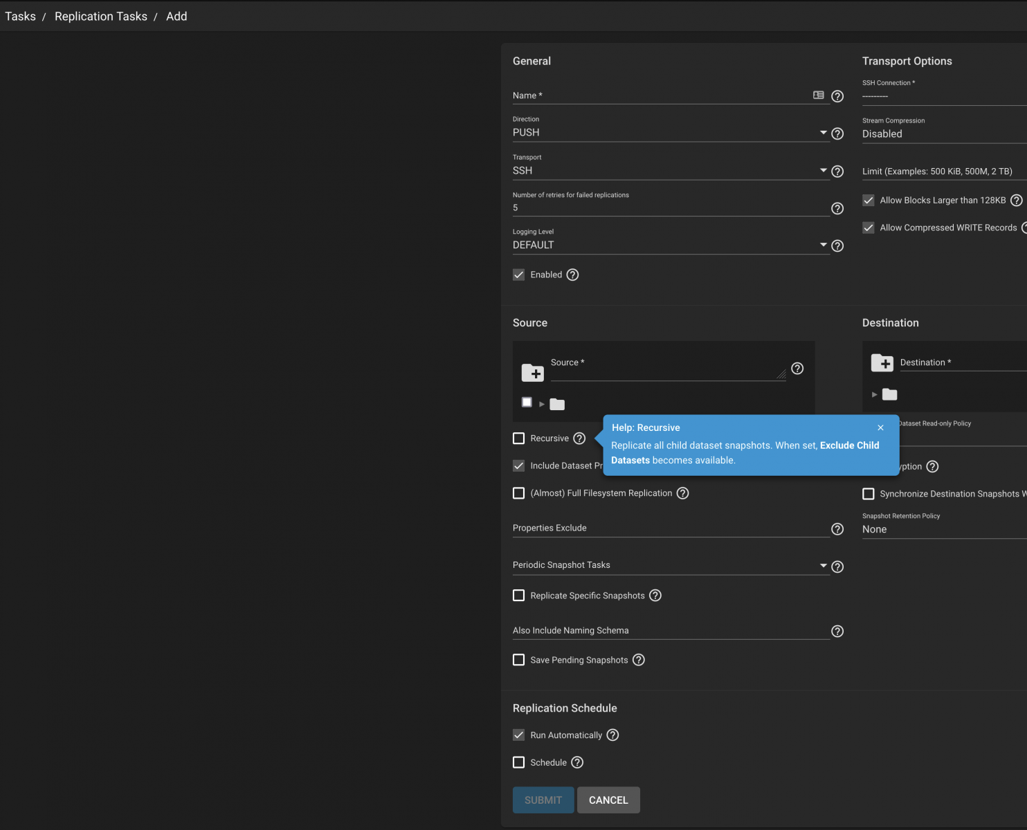

As far as I can remember, I had the replication on pool level before, meaning if I made new datasets in that pool, it replicated them as well. If I do it this way, creating the replication from dataset level, I have to remember to include new ones in the nightly replication as far as I can understand?
Maybe you're looking for this option? (although I see you're in the FreeNAS/Legacy section here and didn't say what you're running, so I'm just assuming the latest TrueNAS version):
You will need to select the Advanced Replication Options to see this screen

Btw the Recursive checkbox is for eventual nested datasets, is it not?
9,700
If you select that checkbox and have the source as the pool root dataset, you'll get all the child datasets in the pool (which should include new ones created after the task... unless you use the exclude option).
