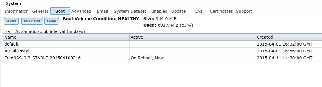

yes 1 gigabit thumb drive and it's still only taking about 60 percent of the drive even with upgrades surprisingly small for everything that it does thanks for the reply will do as recommended
Is this FreeNAS 9.3? It must be one of those Chinese USB sticks one hears about where they put in an 8GB chip and get it to declare itself as 1GB!

I'm pretty sure its Chinese - but yup its a gig and only using about 63% (see screen shot) I dont use jails or anything else so its been fitting fine.

I am mystified that FreeNAS 9.3 will fit in 602MB. Is it compressed in some way? I didn't think that was an option.
I assure there is nothing fancy about what I did - I am just learning this system - I used what was laying around before reading the doc's (like most adventurers out there I am sure just to see what it was all about) and just did the defaults for everything [kinda like things Vanilla]. Everything has just been working so I kept going. Now I am to the point where I want to (re)build it correctly.

I can't remember how much space the original install took, but with 12 boot environments mine is 5.6GB. And the manual suggests a minimum size of 4GB for the install plus 2 updatess. I do recollect it being over 1GB though! It does seem possible that not everything got installed in your case?
