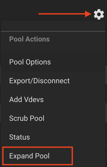

Should I follow instructions here
The autoexpand property is set by default, so it shouldn't be necessary.
If it doesn't happen, you can force it from the GUI under Storage | Pools:
