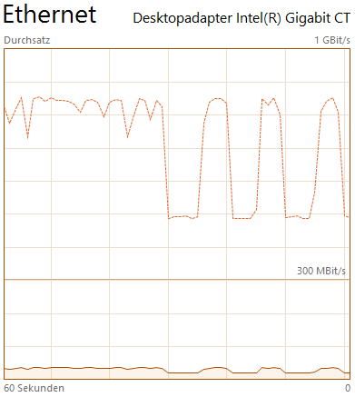

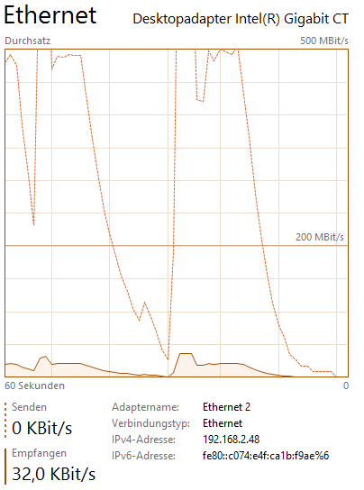

I tried to do some screenshots. In the screenshot 1, you can see the stable file transfer (in the left half of the screenshot) getting a bit slower (right hald of the picture). In the screenshot 5, you can see it collapsing completely.

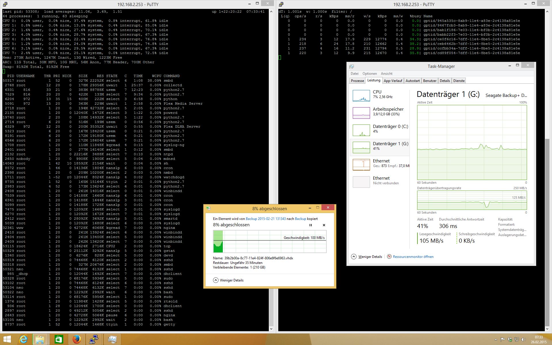

Thank you for all the great ideass, I just did exactly what you proposed.
I forgot to mention one thing. The client has a 500GB SSD for the operating system and an external HDD (2TB seagate) connected via USB 3.0. I'm copying the huge file from the external drive to the FreeNAS-server. The SSD was bought after the firmware problem was corrected, I downloaded the Samsung tool, which confirmed that the firmware is not affected and I'm not having any problems with the SSD. But a good idea! :smile:
I made you two screenshots, both showing the gstat and top-output as well as the windows taskmanager (with HDD activity of the external drive, CPU activity of the client) and the windows copying-window with the current data rate.
In the first screenshot, you see the beginning of the transfer, where the data rate is close to 100MB/Sec, all the server-CPUs are between 20% and 40% busy and the gstat output shows 30-40% disk activity. The values are staying like this during the "ok-phase" of the file transfer. on the client-side, the disk activity is around 40%, and CPU-activity stays at around 5-10%.
In the second screenshot (transfer dropping to 0), the client-CPU-activity drops to around 2%, HDD disc-activity drops to around zero and on the server, all CPUs are nearly idle. Server disc activity drops to around 20% and a bit later to around 0. But the server disc latency numbers never get higher than 50ms under load and 10ms when the transfer is stalling.

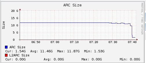

One funny thing is the arc-cache. The cache size drops from 11GB to around 1.5GB. I attached a screenshot of that, too.

I agree with your assessment, I don't think Freenas is the issue. Could be an issue with Samba though, but nothing seems to point there either.
I think the issue is with your client.
The mouse not moving is probably caused by USB2.0 sharing the same PICe lane as the one used by the USB3.0 hard drive. That or your motherboard has a USB hub connecting both mouse and HDD. Not an issue I think. However the mouse is supposed to interface with Windows via the USB 2.0 Interrupt transfer mode, which must occur every 125us and is therefore supposed to be guaranteed, while HDD transfer is done via Bulk transfer and can account for up to 80-90% of the USB2.0 bandwidth, but here HDD transfer is done through USB3.0 which is a full duplex over 5Gbit/s link. The processor, hub or any other chipset/IC manipulating those link may be stretch too thin, or Windows is having some resource issues.
The ARC dropping graph is not the issue. What I think is happening is that Freenas is trying to cache the data and during the copy process flush the old data and replaces it with the new one. However, when copy is interrupted, the content of the cache doesn't point to any existing and complete set of data so the cache is flushed.
I have same ARC behavior on my system, but no drop in transfer.
I suspect your USB3.0 is the cause of the problem, possibly fighting for some resources with the SSD.
Can you check whether the USB3.0 device is not resetting for some reason?
Can you check error logs in Windows 8? What do you find under "Event Viewer", anything errors or warning Windows would detect?
