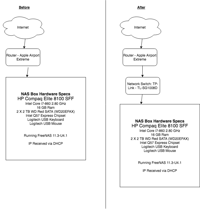

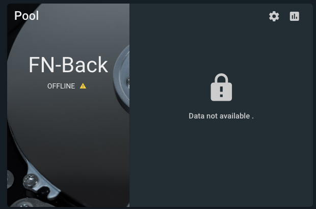

Hardware wise the only change was the addition for a network switch (please see the network diagram) from which FreeNAS receives the IP (yes, I am using DHCP). Not even the location of the ports connectors changed. I boot the box and the only pool I had is now offline.

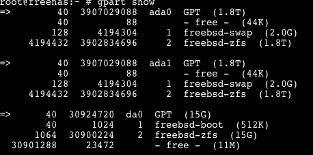

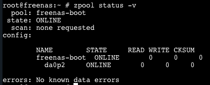

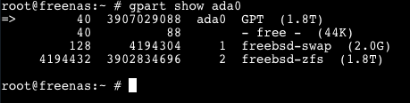

Trawling through the other threads I did run some shell commands like gpart show and zpool status -v. But I am no expert in FreeNAS or Free BSD and cannot think why this would happen.

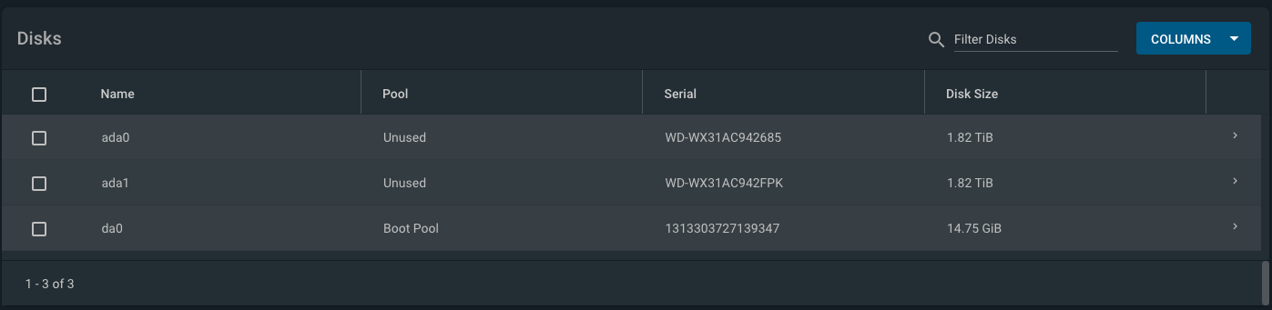

Please see the attached screenshots. Could you please help?

You can connect to the system via the webUI and DHCP address. .. so it doesn't appear to be a networking issue. The two drives appear to be unused and not in the pool. Is this aligned with your view of the situation?
pulkit.agrawal
Sep 6, 2020
12
Yes, that is correct. Before physically moving the box, I had the drives in the pool and had actual data stored on them. Also installed the PlexMediaServer plugin and used the Plex app on my phone to access the data outside the network via cloud.

I can't see you've done anything wrong.. except physically move the box. Has something been knocked loose?
After that it's a process of re-importing the pool... unless others have a better idea.
9,700
Those 2TB disks are EFAX... that's SMR, so you are going to have problems at some point if not already.

i hope you have a backup of your NAS. First of all get rid of the SMR drives..those will continue to cause issues..especially during times of high usage like resilvers. Also since the tracks are overlapping in an SMR situation it's entirely possible the heads got bumped in transit and "lost" their tracking info needed to keep the overlapping data tracks properly aligned(seen quite a few laptops with smr drives drop like this). IMO your data might be totally gone..and I would get non-smr drives going forward.
