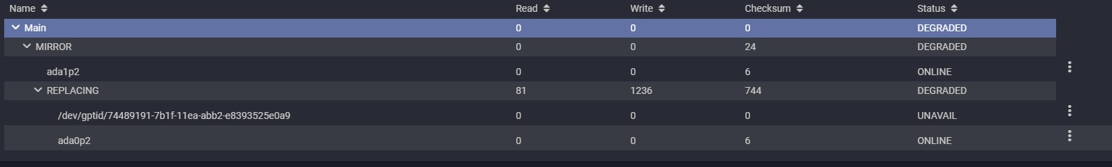

I'm complete noob in freenas and I think that I didn't read the manual of how to replace drives.
So, my Main pool has been being resilvered at leased half a year.
I'm using FreeNAS 11.3, what's happening is:
The problem is that I cant replace this 2 drives.
What should I do to fix this continues replacing?

Replacing and resilvering aren't the same thing.
What does zpool status -v show you?

root@FreeNas Server[~]# zpool status -v
pool: Main
state: DEGRADED
status: One or more devices is currently being resilvered. The pool will
continue to function, possibly in a degraded state.
action: Wait for the resilver to complete.
scan: resilver in progress since Mon Mar 8 07:29:47 2021
1.12T scanned at 34.4M/s, 947G issued at 28.4M/s, 3.51T total
772G resilvered, 26.34% done, 1 days 02:33:51 to go
config:
NAME STATE READ WRITE CKSUM
Main DEGRADED 0 0 12
mirror-0 DEGRADED 0 0 24
gptid/74307b83-7b1f-11ea-abb2-e8393525e0a9 ONLINE 0 0 6
replacing-1 DEGRADED 81 1.21K 744
8055412159345011690 UNAVAIL 0 0 0 was /dev/gptid/74489191-7b1f-11ea-abb2-e8393525e0a9
gptid/7efbe6d2-c9bd-11ea-a8f3-e8393525e0a9 ONLINE 0 0 6
<metadata>:<0x62>
pool: Main
state: DEGRADED
1.12T scanned at 34.3M/s, 947G issued at 28.3M/s, 3.51T total
772G resilvered, 26.34% done, 1 days 02:39:14 to go
config:
<metadata>:<0x62>

<metadata>:<0x62>
So here's the problem, which means that the resilver can't finish and unfortunately the only solution is a pool rebuild since you can't manually restore metadata.
Copy the files off the pool to a backup media, destroy the pool, rebuild it and copy the files back.

Thanks for that, I've been thinking that I am dumb and cant find the solution, but there is no solution without destroying though)
