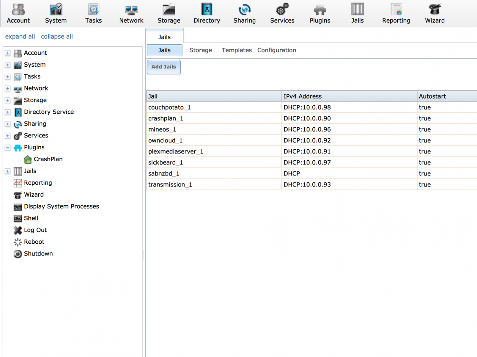

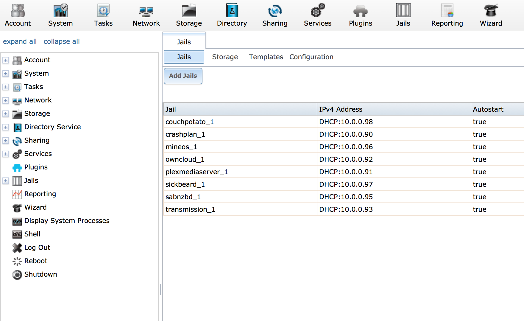

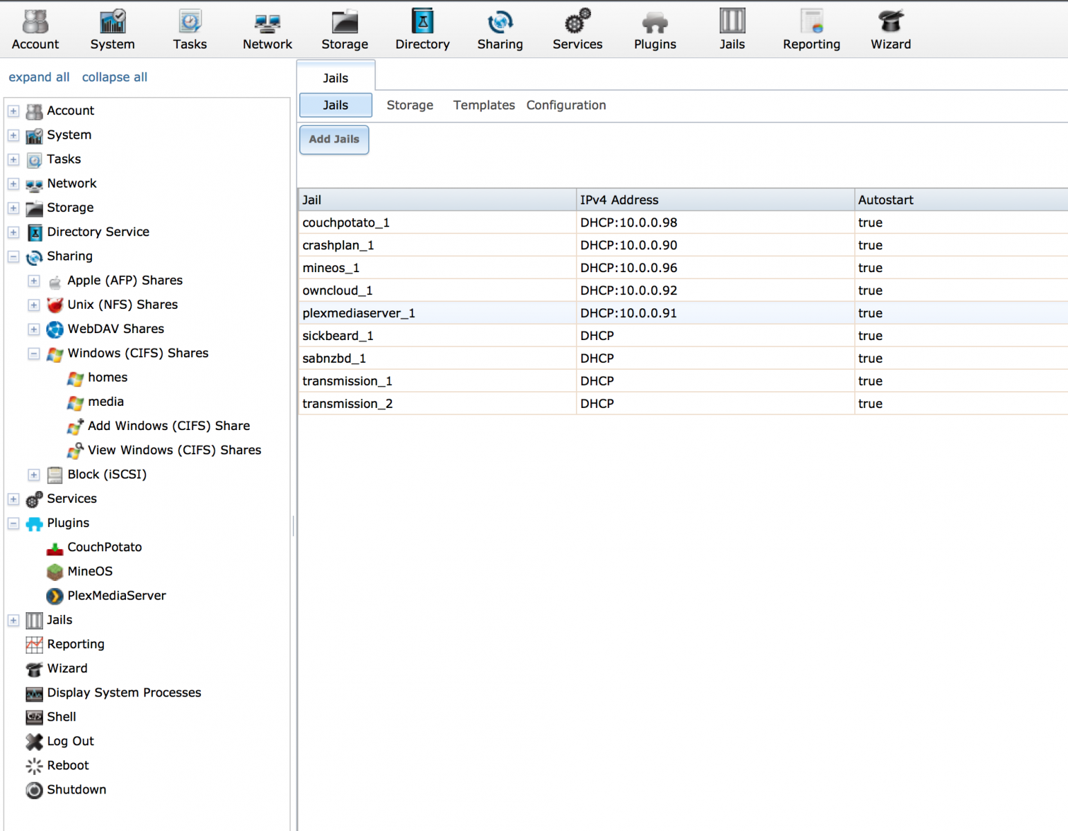

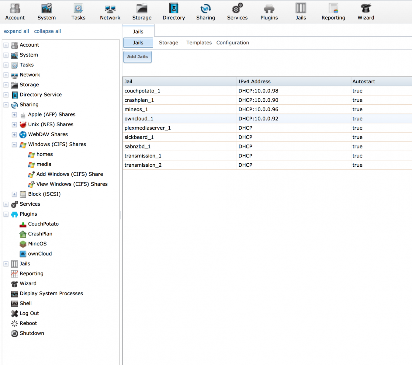

I have the same issue with the plugins tree in the left pane. Depending on which jails are running I'll see different plugins in the tree, if all jails are running I won't see any plugins. Crashplan refuses to run when other plugins are running.
Screenshot 2014-11-15 13.57.09.png Screenshot 2014-11-15 13.56.43.png Screenshot 2014-11-16 19.58.33.png Screenshot 2014-11-16 19.57.48.png
