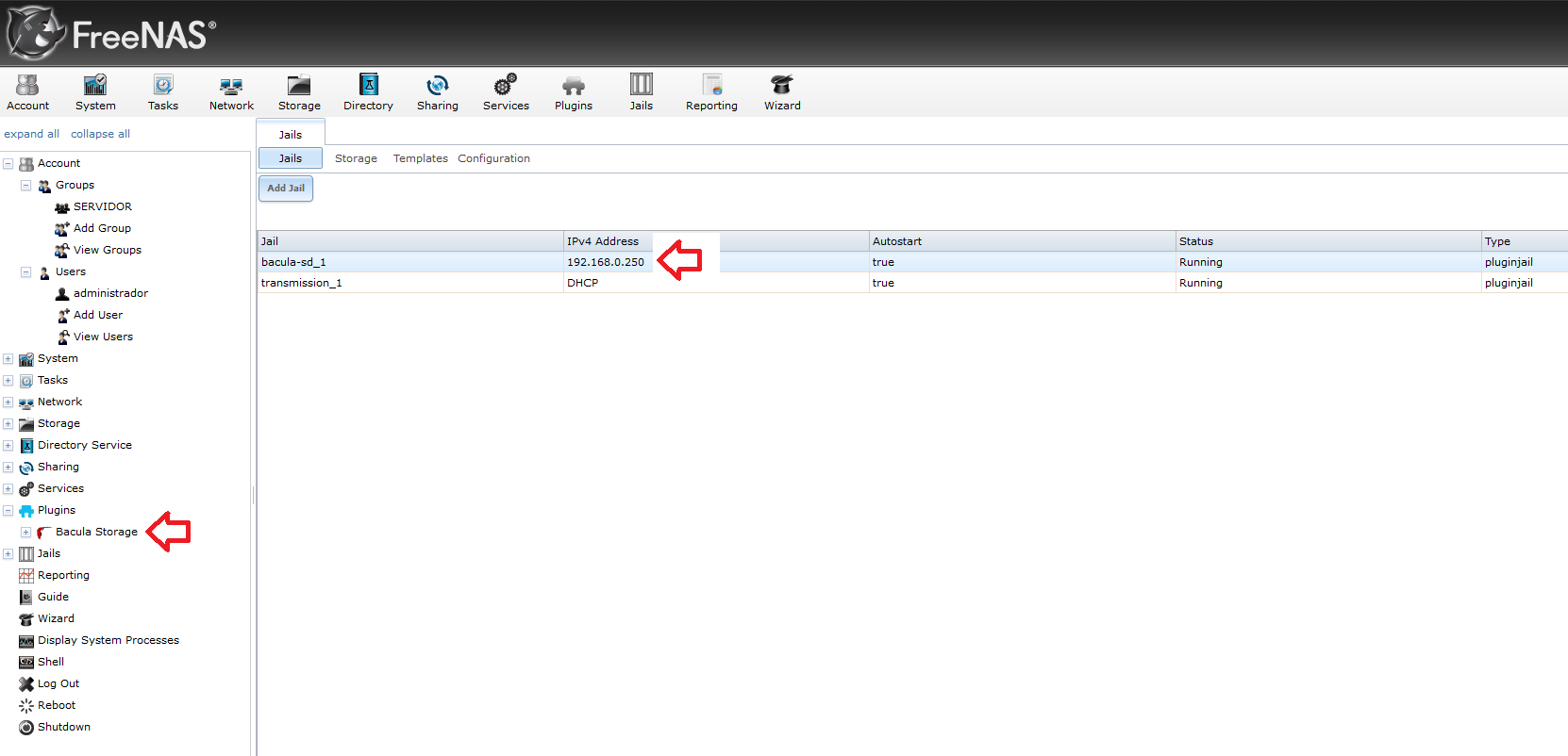

Hi! i´m new here!
I have a problem with plugins, i am trying to install a pluging, but after install i can see on "Installed", but not on Plugins tree (left side).
I can´t turn on the service under "Installed" too...
I use FreeNAS 9.3 STABLE
Thanks!!

What errors show up in /var/log/messages when you try to turn the plugin's service to ON?
Joshua Parker Ruehlig
Dec 5, 2011
5,949
do your jails have working networking? from one of the installed jails can you ping your router?

Oscarhannud
Jun 29, 2012
10
I SOLVED!!!!
My Jails were with DHCP enabled, on configuration, now i filled with a Static IP and now is showing on left side !
Thanks
