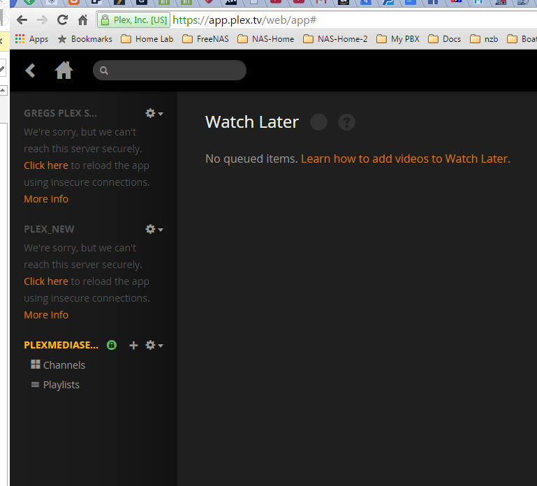

Plex just announced a new update (0.9.12.3) which adds DigiCert SSL certificates to the media server. Given some of the https related issues above, I'm hesitant to try an upgrade. Has the OP confirmed that JPR's mentioned fix is working? Especially since the github link above is titled: "Don't verify SSL connections to FreeNAS". Which seems to negate what Plex just released. I may be wrong though.

Woo-hoo - testing looks good!
root@plexmediaserver_2:/ # fetch --no-verify-peer -o PMS_Updater.sh https://raw.githubusercontent.com/mstinaff/PMS_Updater/master/PMS_Updater.sh
PMS_Updater.sh                                100% of 8482  B  119 MBps 00m00s
root@plexmediaserver_2:/ # chmod 755 PMS_Updater.sh
root@plexmediaserver_2:/ # ./PMS_Updater.sh -u USERNAME -p PASSWORD -a
The bottom (3rd) server is the test PMS using SSL.

Thank you, sir.
Apparently Samsung Smart TV doesnt't support SSL yet. But web and android app work just fine.
