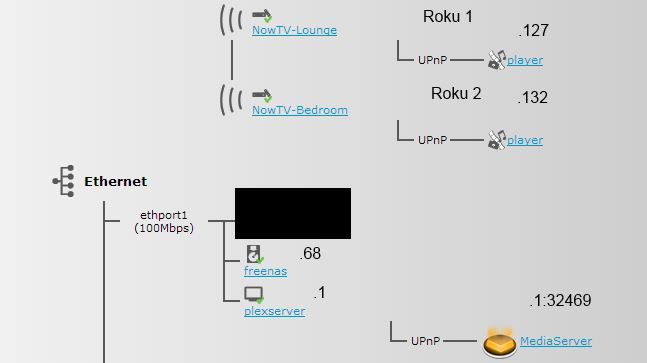

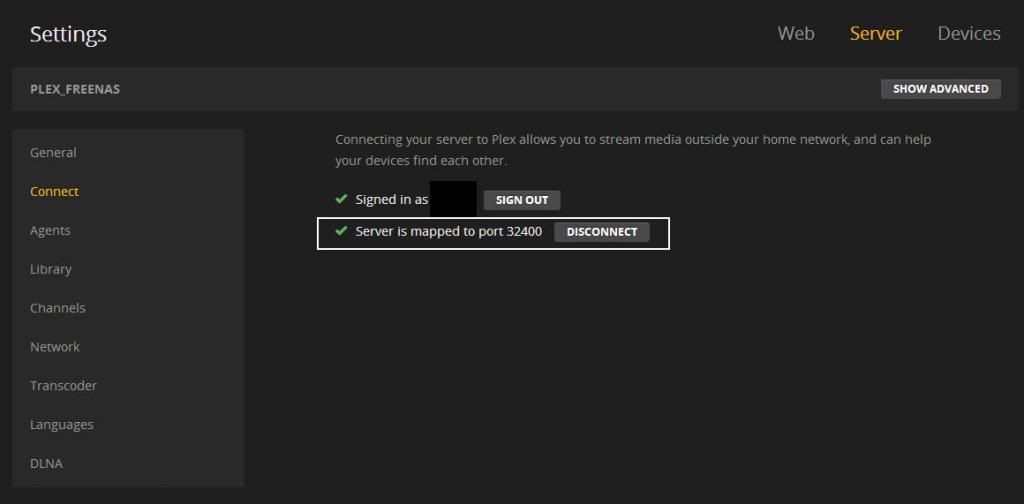

Anyway, that highlighted another issue - i.e. in the plex plugin settings, it stated that it couldn't connect to the server. I configured port forwarding (port 32400) and assigned it to the IP address of my FreeNAS box (.68 on my network). This didn't work and the server remained offline. I then took a look at the nework diagram on my home router and found the plex server was actually using the .1 IP address. I presume this is because it is running as a virtual machine within FreeNAS.
My router wouldn't let me create a rule to forward traffic to the .1 (plex jail) IP address.
I ended up placing the .1 IP in the router's DMZ. This resolved the problem and the server is now connected correctly.

I managed to assign the port forwarding to the .1 IP address of the plex jail. I've no idea why it wouldn't work before, but it is working now.
