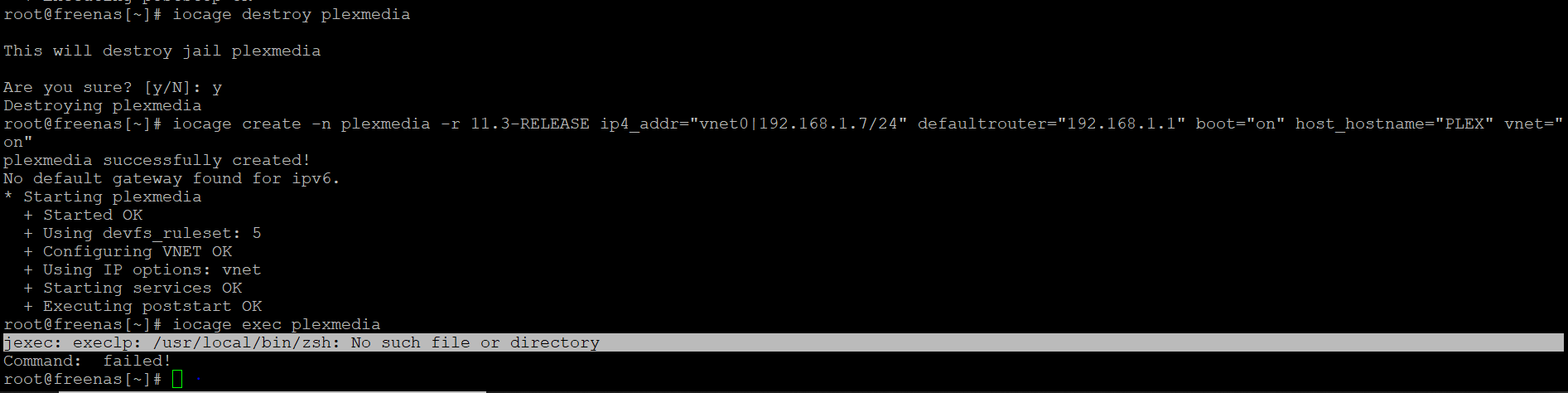

Thanks John Digital for going thru the time to do this. Crack open a cold one my man. Using Putty, everything worked great until I did
iocage exec plexmedia
Then it said rather abruptly, Failed!

Its trying to use zsh shell. IDK why. Ok, instead of iocage exec do this (its the same thing).
jls This will list the jails in a more "old fashioned manner". I still prefer doing it this way. Take note plexmedia's jail ID #
jexec # csh Substitute # for the actual integer you found using jls, enter jail using the csh shell.
Now continue where you left off. "ping yahoo.com"

Also me thinks iocage console plexmedia will also get you there.
Jan 7, 2015
1,153
You had me thinking I was nuts, I do use iocage exec plexmedia to enter, it works for me fine. Generally this is used to run commands in a jail without entering the jail. I think iocage console is more proper way. All ways *should work though, so idk.

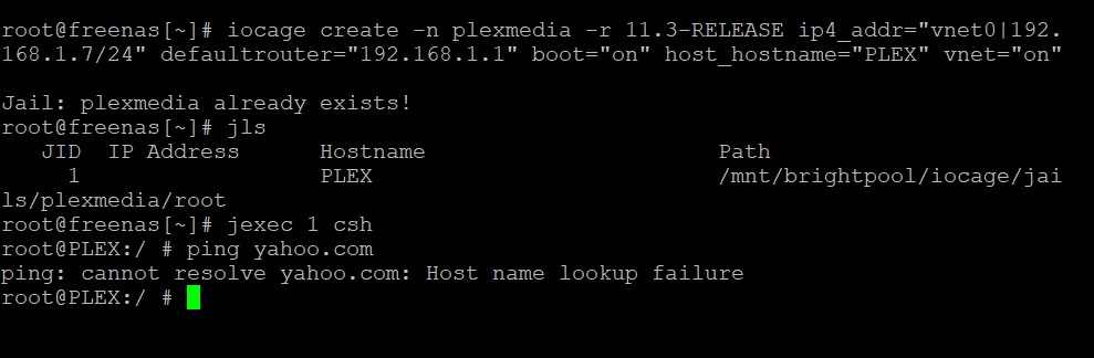

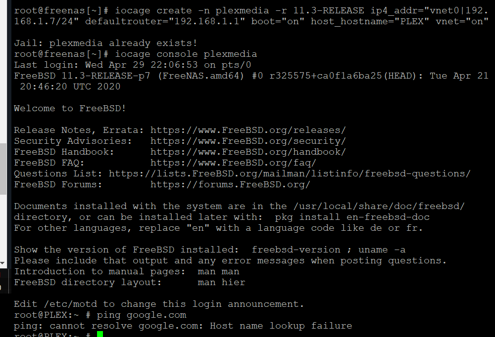

Ok, I was able to move up a step and create a jail, but I can not ping anything from it. I snipped my results.
I also tried the other method and it didn't work either.......
We
Well, luckily I'm off tomorrow, and the next day, and the next day, and the day after that, etc.... Plenty of time to figure this out. Thanks again for all your help.

So this jail also has internet problems. So there is an underlying network issue. Its why pkg couldnt be retrieved from your OP
Jan 7, 2015
1,153
I didnt see your second post. The jail is created and you are entering it.. But the jail isnt getting internet over vnet0 it appears.

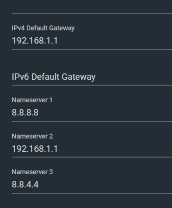

Can you fill me in on your DNS issues that you said were resolved? This is definitely sounding routing and or DNS related. Another item to check in Network in the FN GUI is what nameservers FreeNAS is using as these are passed to jails to also use. You may use any you like but for ever and ever I've always just used 4.2.2.1 and 8.8.8.8 in either combination as primary/secondary bypassing my isp DNS addressing. Maybe your using the gateway as a DNS server or something simple and your router isn't playing along, idk.
djbrightside
Oct 29, 2015
13
DNS issues.......After the initial build, I was able to set up Pool/dataset and get a SMB to share, but I couldn't set up a jail, nor could I get Freenas to update. Someone recomended it was a DNS issue in my Global configuration. Well, sure enough when I entered my default gateway IP and DNS server, I was able to create a jail, and I could do a Freenas update check. I assumed all was well but that's as far as I got, setting up a jail. I still can't get Plex to install either thru shell or thru Plugins tab in GUI. Here's the post........
When I did Ipconfig/all in windows I got a DNS server address. Here's the global config i have.
