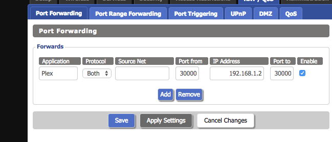

guys, I need your serious help.
1. i set up ddwrt on my router, which is tplink.
2.i have installed freenas, installed plexmediaserver plug in
3.it is working on the local network.
Let me just explain the connections.
ATTU verse modem out-port 1 connected to in-port 1 of the tplink
first outward port of the tplink connected to the freenasbox.
I have ip address of the freenas machine, and also ip address on the plexmediaserver jail. ( i understand that both are different)
My next issue is connecting to the remote server.
I tried going on the ddwrt router and went to port range forwarding and put the port setting and ip setting as in the picture 1
On the web interface of the plexmediaserver when i try to connect by manual port forwarding the picture i get is picture 2.
Can anyone suggest me what i am doing wrong.
would like to get remote access so that i can access the media remotely.
All the help is appreciated.

SweetAndLow
Sweet'NASty
Nov 6, 2013
6,421
you didn't forward any ports to anything. You need to modify the port forwarding in dd-wrt not the port range forwarding. So configure it like this:
Nat/QoS -> port forwarding ->
Application: plex
Protocol: both
source net:
port from: 30000
ip address: 192.168.1.2
port to: 32400
enabled: checked
MacAspirer
May 23, 2014
20
I have made the changes and did portforwarding. then i got the following please see the pictures.
Thanks for helping me.

SweetAndLow
Sweet'NASty
Nov 6, 2013
6,421
make your port to setting 32400
