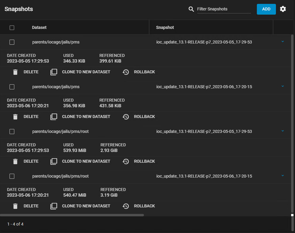

artlessknave
Oct 29, 2016
1,506
do you have snapshots enabled? each snapshot will use space for ALL changes.
zfs list -t snapshot | grep /mnt/parents/iocage/jails/pms/
additionally, PLEX can cache things like trans-coded media. if it's caching to the jail, the jail will grow.

Interesting. But I don't think that's the space use issue.
root@parentstruenas[~]# zfs list -t snapshot | /mnt/parents/iocage/jails/pms/ zsh: permission denied: /mnt/parents/iocage/jails/pms/ root@parentstruenas[~]# sudo zfs list -t snapshot | /mnt/parents/iocage/jails/pms/ zsh: permission denied: /mnt/parents/iocage/jails/pms/ Sorry, user root is not allowed to execute '/usr/local/sbin/zfs list -t snapshot' as root on parentstruenas.local.
Inside the jail it's command not found, no datasets available.

artlessknave
Oct 29, 2016
1,506
my bad. i forgot the grep. corrected the original post..
believe there is a way to do that within the zfs list command but I never remember it
this would not work within a jail.

The grep one ends with nothing returned but I took out the pipe and came up with this.
root@parentstruenas[~]# zfs list -t snapshot | grep /mnt/parents/iocage/jails/pms/ root@parentstruenas[~]# zfs list -t snapshot NAME USED AVAIL REFER MOUNTPOINT boot-pool/ROOT/13.0-U4@2023-02-10-18:32:53 1.84M - 1.29G - boot-pool/ROOT/13.0-U4@2023-03-18-05:31:25 1.93M - 1.29G - parents/.system/samba4@wbc-1676154798 176K - 389K - parents/.system/samba4@wbc-1676238683 144K - 373K - parents/.system/samba4@wbc-1676588044 149K - 389K - parents/.system/samba4@wbc-1676740468 149K - 389K - parents/.system/samba4@update--2023-03-18-12-32--13.0-U3.1 139K - 389K - parents/.system/samba4@wbc-1679142867 123K - 389K - parents/iocage/jails/pms@ioc_update_13.1-RELEASE-p7_2023-05-05_17-29-53 346K - 400K - parents/iocage/jails/pms@ioc_update_13.1-RELEASE-p7_2023-05-06_17-20-15 357K - 432K - parents/iocage/jails/pms/root@ioc_update_13.1-RELEASE-p7_2023-05-05_17-29-53 540M - 2.93G - parents/iocage/jails/pms/root@ioc_update_13.1-RELEASE-p7_2023-05-06_17-20-15 540M - 3.19G -
root@parentstruenas[~]# zfs list | grep parents/iocage parents/iocage 8.60G 3.52T 8.73M /mnt/parents/iocage parents/iocage/download 835M 3.52T 128K /mnt/parents/iocage/download parents/iocage/download/13.0-RELEASE 401M 3.52T 401M /mnt/parents/iocage/download/13.0-RELEASE parents/iocage/download/13.1-RELEASE 434M 3.52T 434M /mnt/parents/iocage/download/13.1-RELEASE parents/iocage/images 128K 3.52T 128K /mnt/parents/iocage/images parents/iocage/jails 4.44G 3.52T 128K /mnt/parents/iocage/jails parents/iocage/jails/pms 4.44G 3.52T 421K /mnt/parents/iocage/jails/pms parents/iocage/jails/pms/root 4.44G 3.52T 3.21G /mnt/parents/iocage/jails/pms/root parents/iocage/log 133K 3.52T 133K /mnt/parents/iocage/log parents/iocage/releases 3.34G 3.52T 128K /mnt/parents/iocage/releases parents/iocage/releases/13.0-RELEASE 1.63G 3.52T 128K /mnt/parents/iocage/releases/13.0-RELEASE parents/iocage/releases/13.0-RELEASE/root 1.63G 3.52T 1.63G /mnt/parents/iocage/releases/13.0-RELEASE/root parents/iocage/releases/13.1-RELEASE 1.71G 3.52T 128K /mnt/parents/iocage/releases/13.1-RELEASE parents/iocage/releases/13.1-RELEASE/root 1.71G 3.52T 1.71G /mnt/parents/iocage/releases/13.1-RELEASE/root parents/iocage/templates 128K 3.52T 128K /mnt/parents/iocage/templates root@parentstruenas[~]# df -h Filesystem Size Used Avail Capacity Mounted on boot-pool/ROOT/13.0-U4 214G 1.3G 213G 1% / devfs 1.0K 1.0K 0B 100% /dev tmpfs 32M 10M 22M 32% /etc tmpfs 4.0M 8.0K 4.0M 0% /mnt tmpfs 2.6G 27M 2.6G 1% /var fdescfs 1.0K 1.0K 0B 100% /dev/fd parents 3.5T 128K 3.5T 0% /mnt/parents parents/busync 14T 11T 3.5T 76% /mnt/parents/busync parents/iocage 3.5T 8.7M 3.5T 0% /mnt/parents/iocage parents/iocage/images 3.5T 128K 3.5T 0% /mnt/parents/iocage/images parents/iocage/templates 3.5T 128K 3.5T 0% /mnt/parents/iocage/templates parents/iocage/jails 3.5T 128K 3.5T 0% /mnt/parents/iocage/jails parents/iocage/download 3.5T 128K 3.5T 0% /mnt/parents/iocage/download parents/iocage/releases 3.5T 128K 3.5T 0% /mnt/parents/iocage/releases parents/iocage/log 3.5T 134K 3.5T 0% /mnt/parents/iocage/log parents/iocage/download/13.1-RELEASE 3.5T 434M 3.5T 0% /mnt/parents/iocage/download/13.1-RELEASE parents/iocage/jails/pms 3.5T 421K 3.5T 0% /mnt/parents/iocage/jails/pms parents/iocage/download/13.0-RELEASE 3.5T 401M 3.5T 0% /mnt/parents/iocage/download/13.0-RELEASE parents/iocage/releases/13.0-RELEASE 3.5T 128K 3.5T 0% /mnt/parents/iocage/releases/13.0-RELEASE parents/iocage/releases/13.1-RELEASE 3.5T 128K 3.5T 0% /mnt/parents/iocage/releases/13.1-RELEASE parents/iocage/jails/pms/root 3.5T 3.2G 3.5T 0% /mnt/parents/iocage/jails/pms/root parents/iocage/releases/13.1-RELEASE/root 3.5T 1.7G 3.5T 0% /mnt/parents/iocage/releases/13.1-RELEASE/root parents/iocage/releases/13.0-RELEASE/root 3.5T 1.6G 3.5T 0% /mnt/parents/iocage/releases/13.0-RELEASE/root
